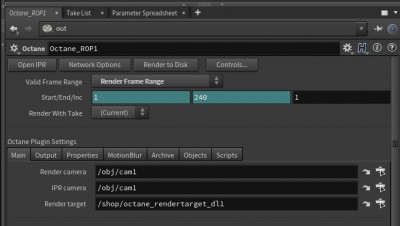

Where do I set the file path in the Octane ROP? I do not see a field to input that info. At the moment I have no idea where this is rendering to. My project is all set to a specific folder but the final render doesn't show up there.juanjgon wrote: if you have the output file options enabled, you should have the rendered files on your disk. You must configure the output path/filename using the $F token to set the file frame numbering, like in Mantra, for example $HIP/render/filename-$F.exr
I currently have Render to Mplay, Overlay render stats and Overwrite Mplay frame all checked. I have Output image files unchecked, I don't need individual images because its an animation, but that is the only place I see to input a file path.
Octane (or Houdini from an ROP node) can't output animation files. You need to save the individual frames and compile the animation using other software. You could try also to export an animation file from MPlay, although to be honest, I've never had any luck with this feature. To have the full animation in MPlay you need to disable the "Overwrite Mplay frame" option.
