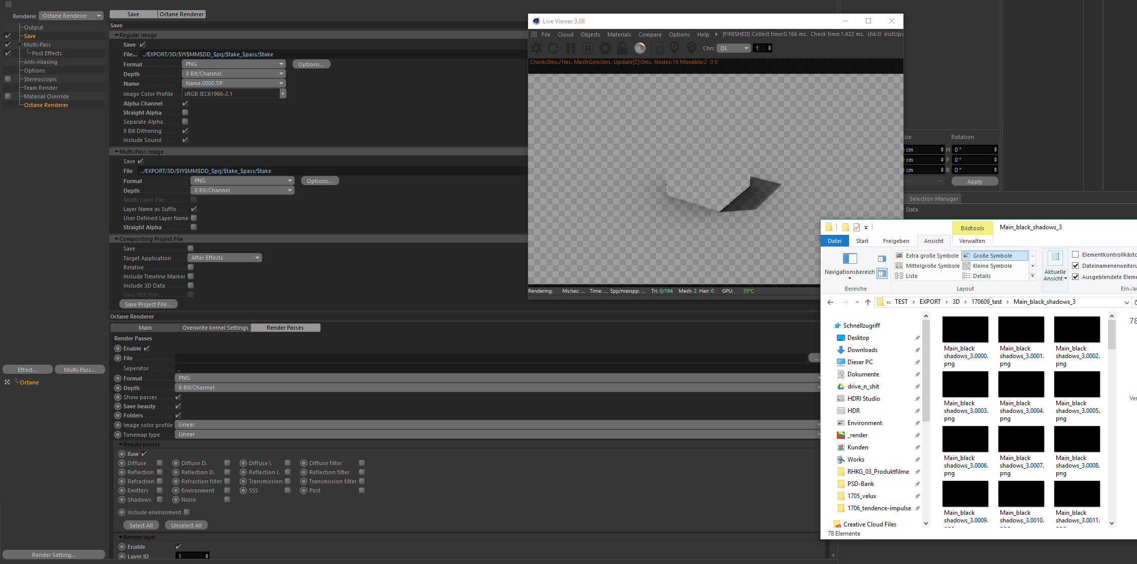

please find attached a screenshot and file. I'm not very used to passes in Octane, the last time I used it everything was a bit messy since tokens werent supported and I was told "not to use the cinema 4d save dialogue". Those times seem over and I am in the need of a matteshadow. In the LiveViewer, everything as suspected. When rendering, Black Shadows are a completely black image without alpha, colored shadows are just white, but reflections render nicely O.o

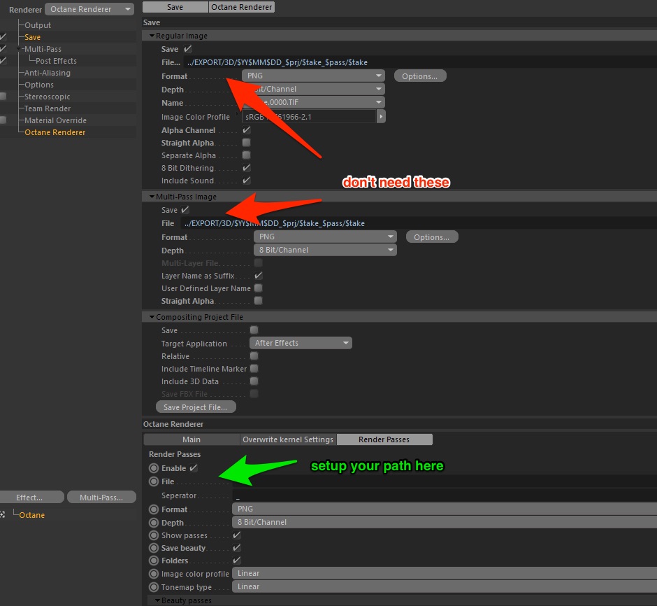

You don't have any output path setup on the octane render tab.

Only empty folders when using tokens or nothing written if using tokes without "folders" checked. Do I really need to name all my stuff by hand all the time?
I don't get it - everything works nicely when rendering via the normal c4d save dialogue - but the passes are without alpha. Seems like a minor fix and would make everything better.
Posts: 16068
Location: Türkiye
philmaron wrote:Only empty folders when using tokens or nothing written if using tokes without "folders" checked. Do I really need to name all my stuff by hand all the time?
It should be fine with 3.06.2. Pls try it.
There should be a reason why i've added extra saving section for passes!!! You've discovered one reason of that. Trust to the developers and go with adviced ways.
