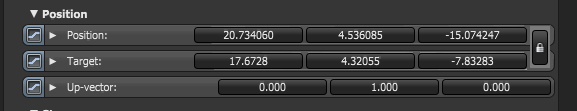

i'm new to the standalone - and what i miss, or have overlooked, is the ability to lock cameras position and target.
could a simple 'lock' be added to the camera settings - like shown on the attached image?
thanks
jorgensen

There is a lock on the rendering viewport

i know there is a 'lock camera' on the render view - but that locks all cameras.
i would just like to lock the camera i have setup with the view i want, then i have a other camera to further explore the model.
it's quite critical if i have setup a render and have started to do post work in ps, and i when, by accident move the camera in octane.
but i might just don't use the standalone version as i'm supposed to do.
jorgensen

That's a good point. That will need specific support I think

i'll prefer a simple click to lock solution - as i'm not so advanced. but there multiple solutions might be useful.

or with a simple "lock" icon?
i'm not an advanced user, so scripting is not an option for me :-/

Posts: 10621
Hi Jorgensen,
yes the idea is to write a scripted graph node with a camera-in and camera-out pin, and a boolean value on/off for locking the camera. The thin-lens camera node need to be exposed, and the scripted graph goes in between the camera and the RT node.
Do you think it could be useful?
ciao beppe
