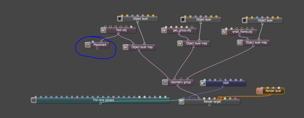

How can I connect an OBJECT to a Placement node, but then add it to an Object Layer Map (OLM) node so that I can add an Object Layer node input too?
A direct Object connection to OLM works fine, but if I have a placement mode (modifying objects scale), the OLM loses ability to have an Object Layer node plugged in.
This means my object cannot have a Render Layer ID assigned (via an Object Layer node - as other elements in the scene have assigned)
Case in point, the floor.obj has a placement modifier, but it that is now unattached / cannot be connected to the geometry group
Thanks, Huw

you need to connect the Object Layer Map node in between the mesh node and the Placement node:

Thanks Peppe, I shall give that a go shortly! Thanks for the quick reply ;-) Cheers, Huw
VFX000
Posts: 3
Joined: Wed May 10, 2017 3:32 pm
That worked! ;-) Cheers...
