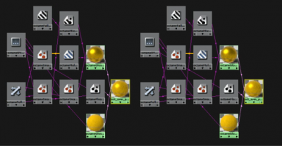

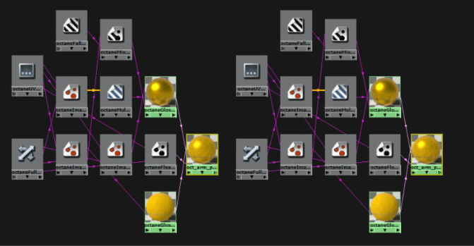

Hi BK
There is a bug in Edit->Duplicate->Shading Network in hypershade. The duplicated mixed material node is not connected to the duplicated shading network instead connected to the originated shading network.
Result
Result
In Version 3.05.3 - 9.41 this works fine.
Expected
Expected
Best regards
Cyrill

BK
Posts: 1579
@gianca, thanks for doing the test. I followed the steps but unable to reproduce the bug on my workstation. Is your GPU overclocked? can you please upload a Maya sample file?
@ cyrillweiss, thank you so much for reporting this. We will get this fixed on our next build. As a workaround please use copy/paste.
