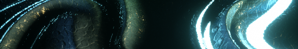

I have a light underneath some plane geometry that is being displaced, so the light gets revealed as the displacement goes below a certain value. However because of this the breaking displacement becomes very obvious in multiple parts of the image.
Is there a way close these gaps somehow easily?

in general, you need to untick the Angle limit option in Phong tag of displaced geometry, or set the angle greater than 90°, to avoid the tearing of the mesh.
