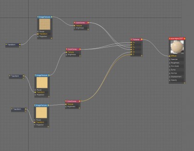

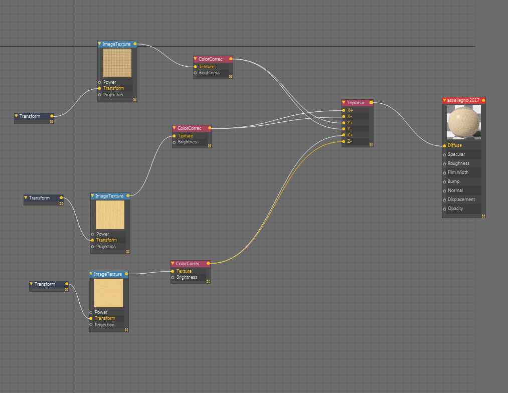

I've created a simple wood material giving three different texture and transformations on the three X,Y,Z planes.
Then I've assigned the material on a cube object.
Now I want to have multiple objects with different orientations, so I have made some copies of the objects and then rotating them in the space.

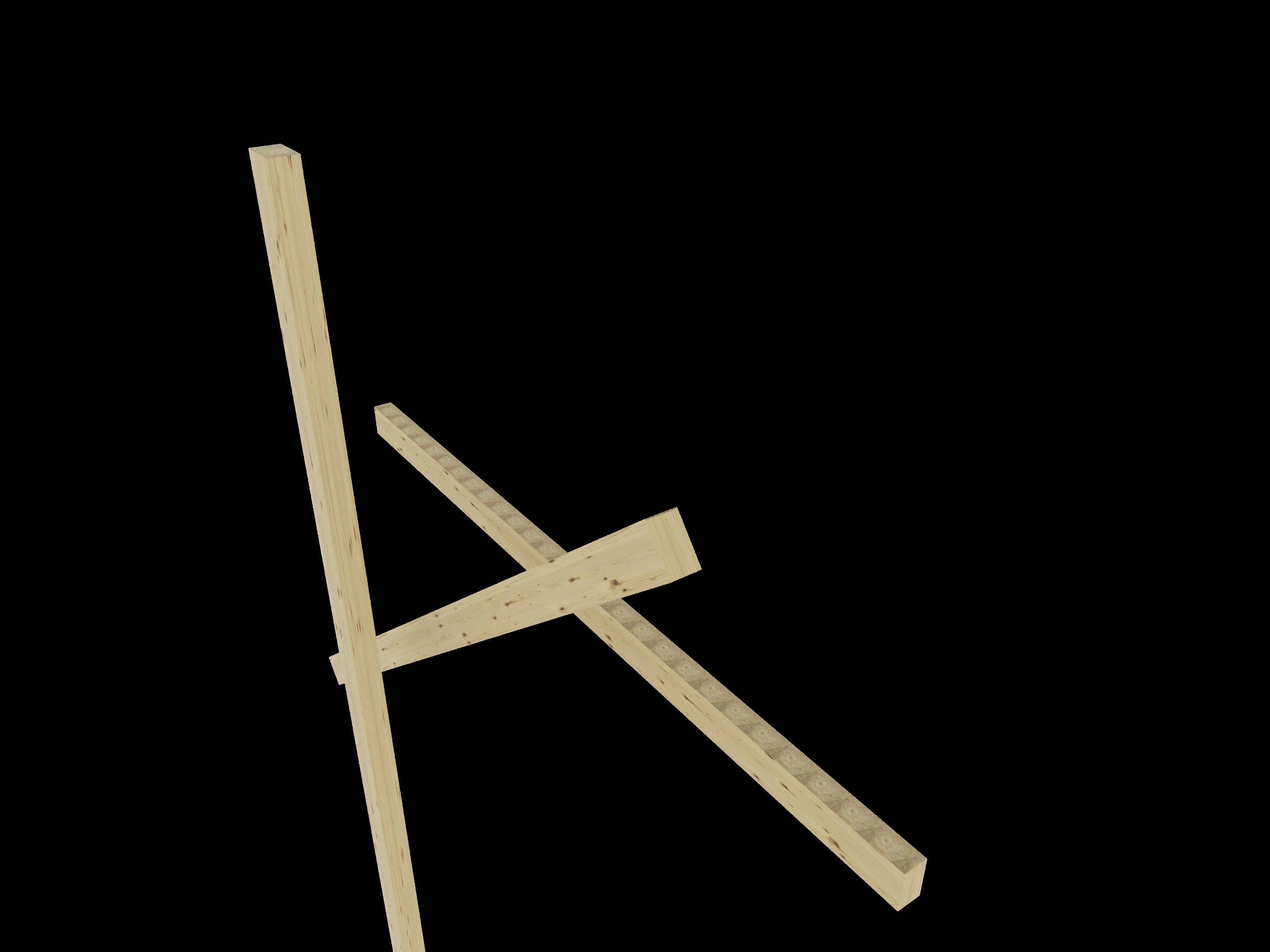

Now I've a trouble if I render in Picture viewer, the texture are wrong mapped on the rotated objects:
I've missed something?

Assign projection node with triplanar to each imagetextures.
