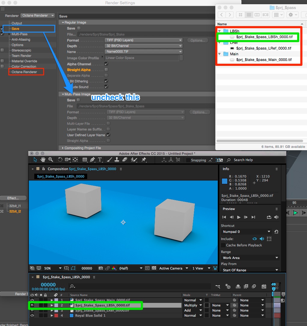

aoktar wrote: Also users should not use C4D's save section for passes. It causes some problems like this. Plugin handles all saving operations when Octane's save section for passes.
I downloaded your project and see that you have C4D's Multi-Pass Image enabled.
I think that might be where the confusion is.
Use the Octane LBSh (Layer Black Shadow) file for your shadow in compositing.
