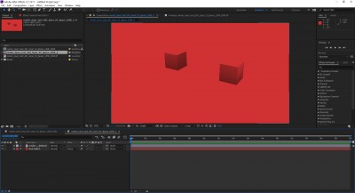

Hi all,
I'm trying to render out an animation in a series of passes in order to do some effects in comp. 99% of what I want to achieve seems to be working perfectly, but the only thing baffling me is the black and coloured shadow pass.
I'm rendering alpha so as far as I'm aware this should enable black shadows, but both that and the colour shadow pass are completely empty. Coloured reflections are working perfectly fine. Here's the thumbnails from the picture viewer:

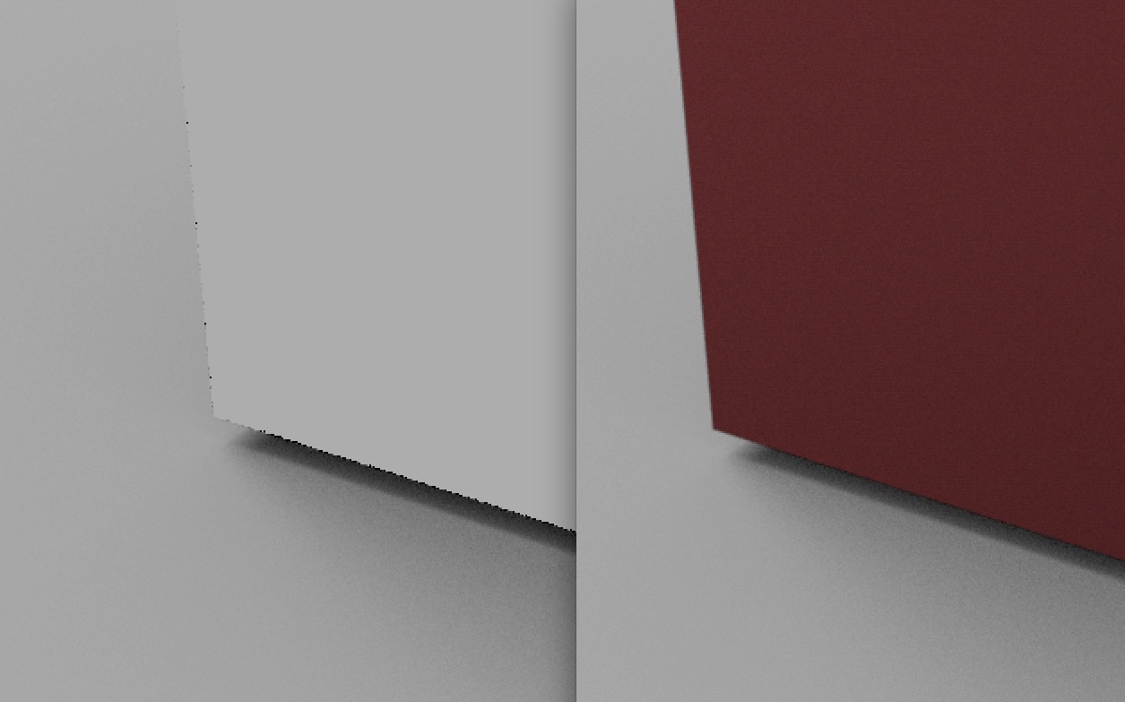

I've discovered that you need to disable coloured shadows to get the black shadow pass. Now in the black shadow pass I get this artifact:
Does anyone know what this is?

I'm not worried about the black dots, that's fine and I'm aware that they will not be seen. It's the large horizontal stripe across the middle of the pass that troubles me.
It looks as if there's no shadow on that part of the render, but that's simply not the case when you look at the beauty pass in the LV.

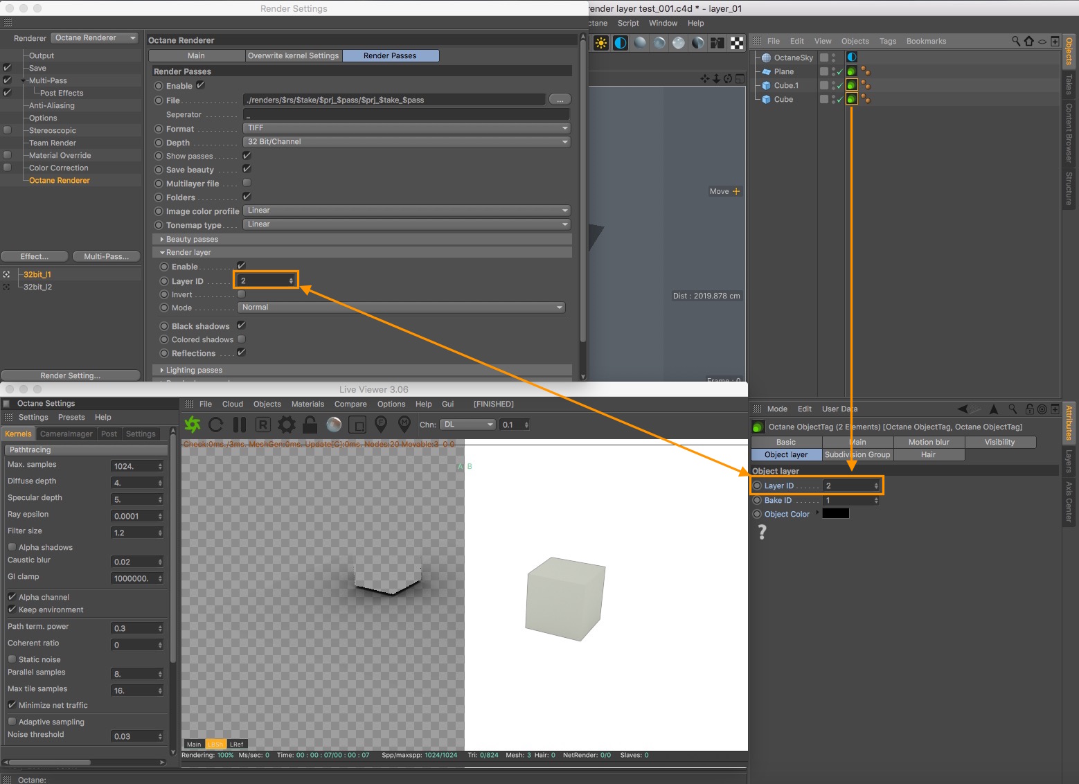

Posts: 10654
Hi fatfreemedia,
sorry but I don't understand the issue, if you want to see the black shadow of the cube on the plane, you have to switch to Layer 2:
ciao beppe
