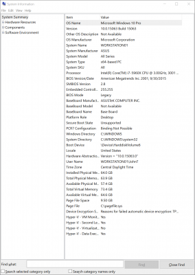

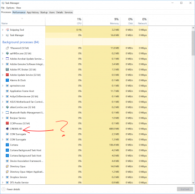

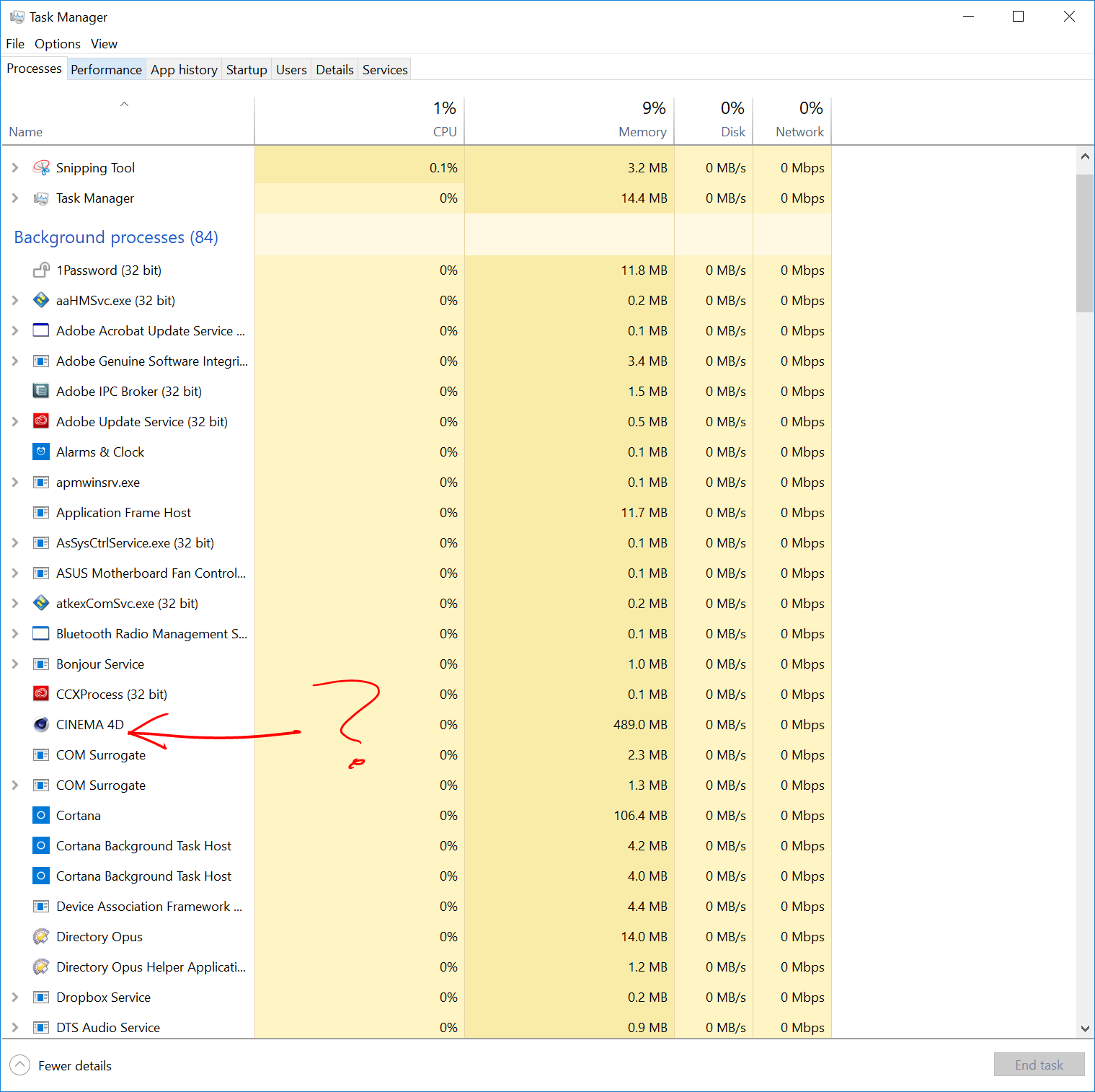

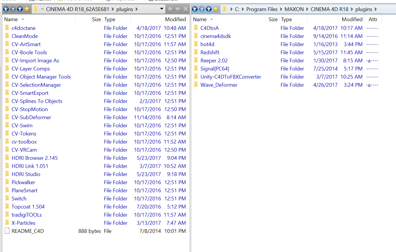

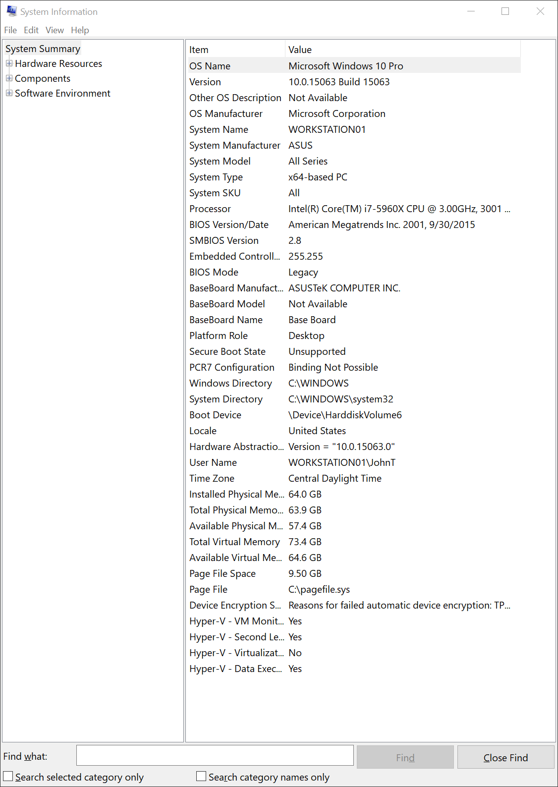

I've attached screenshots of my plug-ins folders, system info and the task manager showing the stuck background process.
This only happen when I use octane in a scene. If I exit C4D without ever touching Octane there are no problems. Please let me know if I can provide you more information on this bug.
As a workaround, do I always need to sign out from the account tab very time until you can fix this plug-in?
