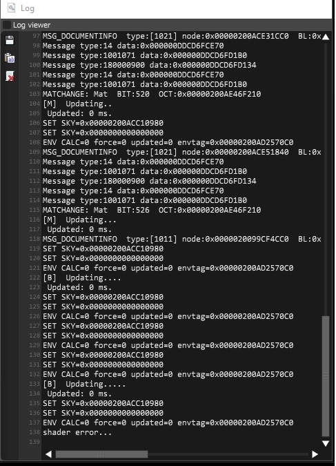

3.06.1
I always very often get an error when I do an LV update.
Sample scene attach.
Untitled [email protected]
(57.74 KiB) Downloaded 214 times
