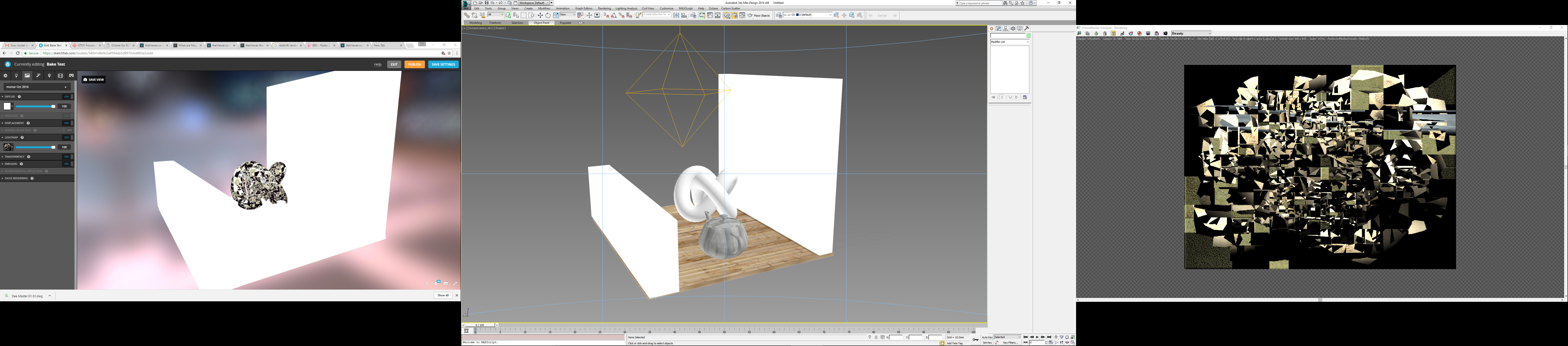

Thanks Paride but that wasn't an overly clear or helpful bit of the manual.
Middle image is the model in max, on the right is the map I got from the bake camera and on the left is what happens when I apply the texture to the material to the model.
If it's a simple procedure could Otoy please do a vid showing what to do.

I havent done much baking.
But it looks like the objects are overlapping in uv space?
Have you unwrapped all the models/objects and made sure they dont overlapp?

Maybe this video will help
thanks goes to Elvissuperstar007 . :)

The baking process needs some steps.
Elvissuperstar007's video can be of help.
When you bake your scene or objects, you have to consider the unwrup process too.
