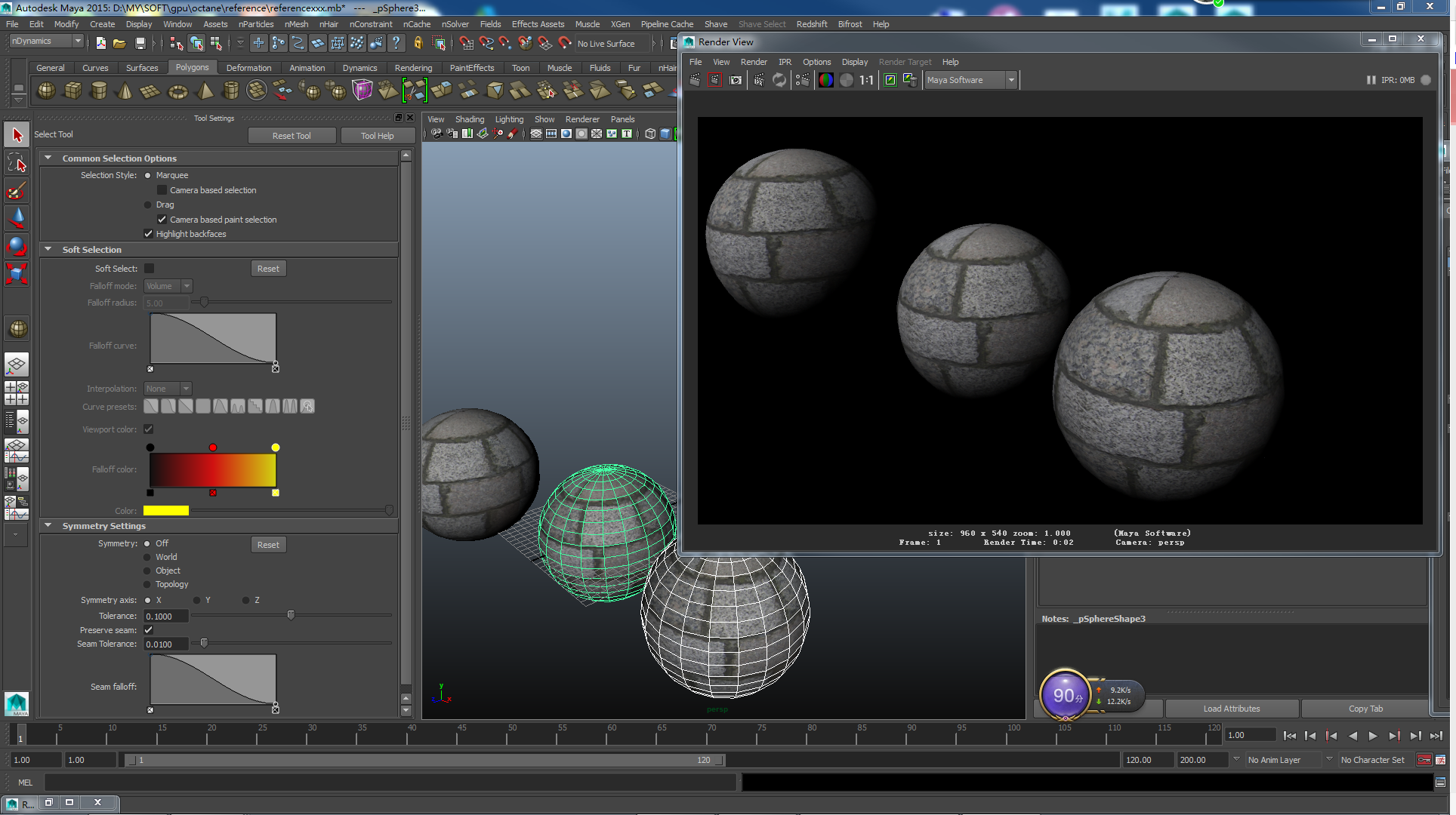

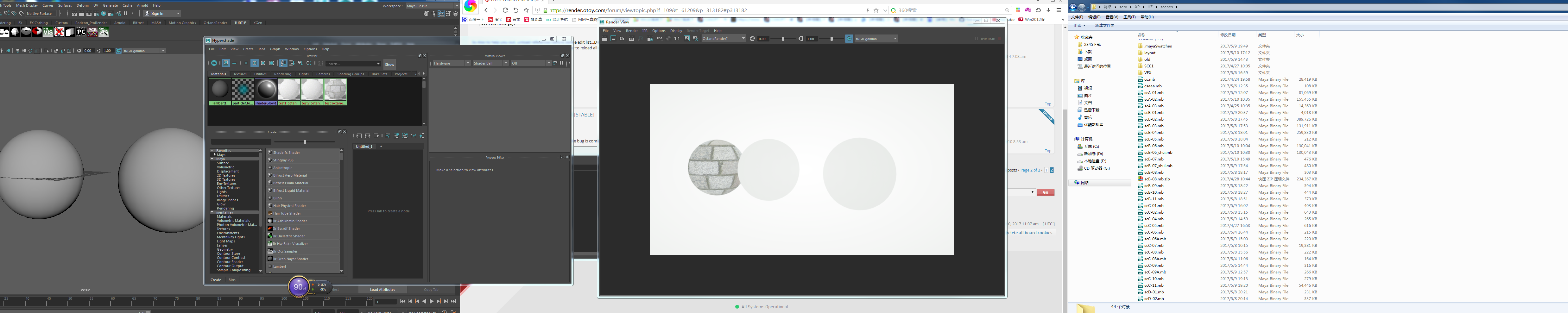

renmaxhb wrote:Look the white guy!
So Also to help you out, unload references before delete edit list...Delete all texts link to shaders on this list not transform so you don't loose any animation,
After that reload references and use a texture manager to reload all octane textures and should be there all textures...
Best,
JO

save and open it again?
First reference will be all right,save and open it again,the bug is come :cry:

@renxhmab I reproduce the bug with your scene,
my workaround doesn't work in this case (as it must be used when scenes are saved I think),
and reloading the References solves the problem only temporary as you say.
So yes it's still the same family bug,
once again the partial fix was just one more patch on top of bad code,
in my opinion we'll see these bugs forever until this part of the code is properly re-implemented from scratch.

I render my more 100 shots in deadline, renderfarm only open maya file and render it,deadline cannot do this about reload reference.
I test it again,save and open ,reference work well at softwre renderer :evil:
