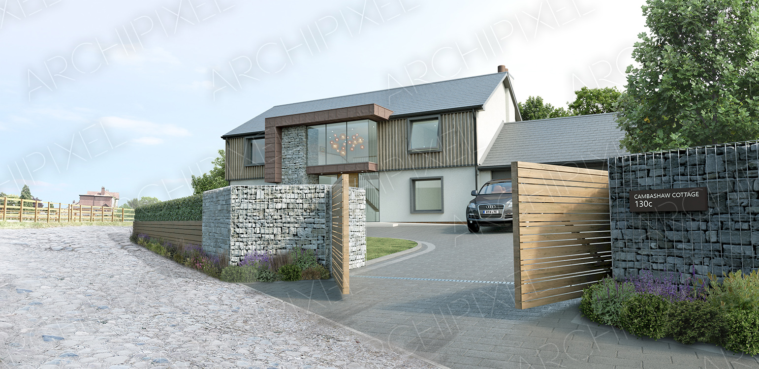

Hi Ahmet,
Thank you for responding so quickly.
I can get the live viewer to render very simple scenes (like a cube and a sphere) but anything more detailed just crashes octane.
I have attached an image of a render that previously worked but does not render now. (The vegetation was added post render)
In an attempt to resolve the issue I downloaded the latest Nvidia driver but this has not made any difference.
I get the error 'Nvidia driver has stopped working and has been recovered successfully'. I have seen this message before but never so frequently.
Thanks,
Andy.
Posts: 16068
Location: Türkiye
These are not belong to plugin side but trying to help you. First you should try with 3.06. If still happens try with some other drivers. Please send us a scene if it still happens. Also it maybe a hardware problem but not sure.
