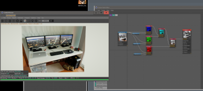

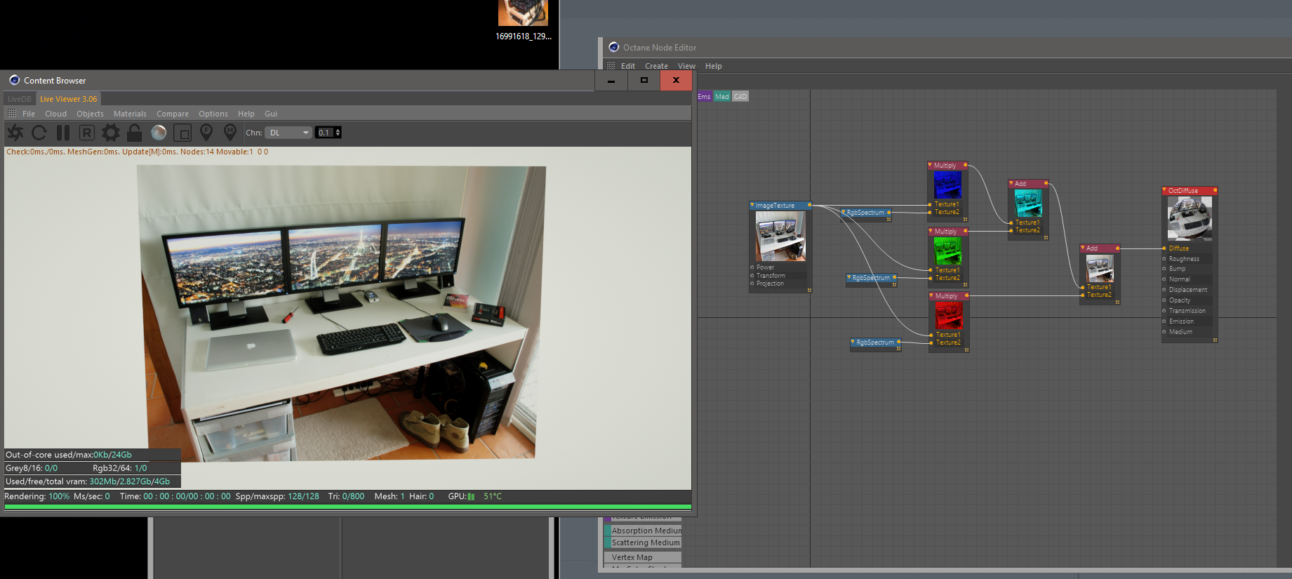

It actually worked perfectly... Now I feel stupid for now seeing something so clear, basic math you input a matrix one side with different values then multiply two of them by 0 and you get a what's left on the other side.
Thank you very much! I will leave an image attached here with the process in case someone else gets here in the future.
Example I'm using a random image from the internet.
