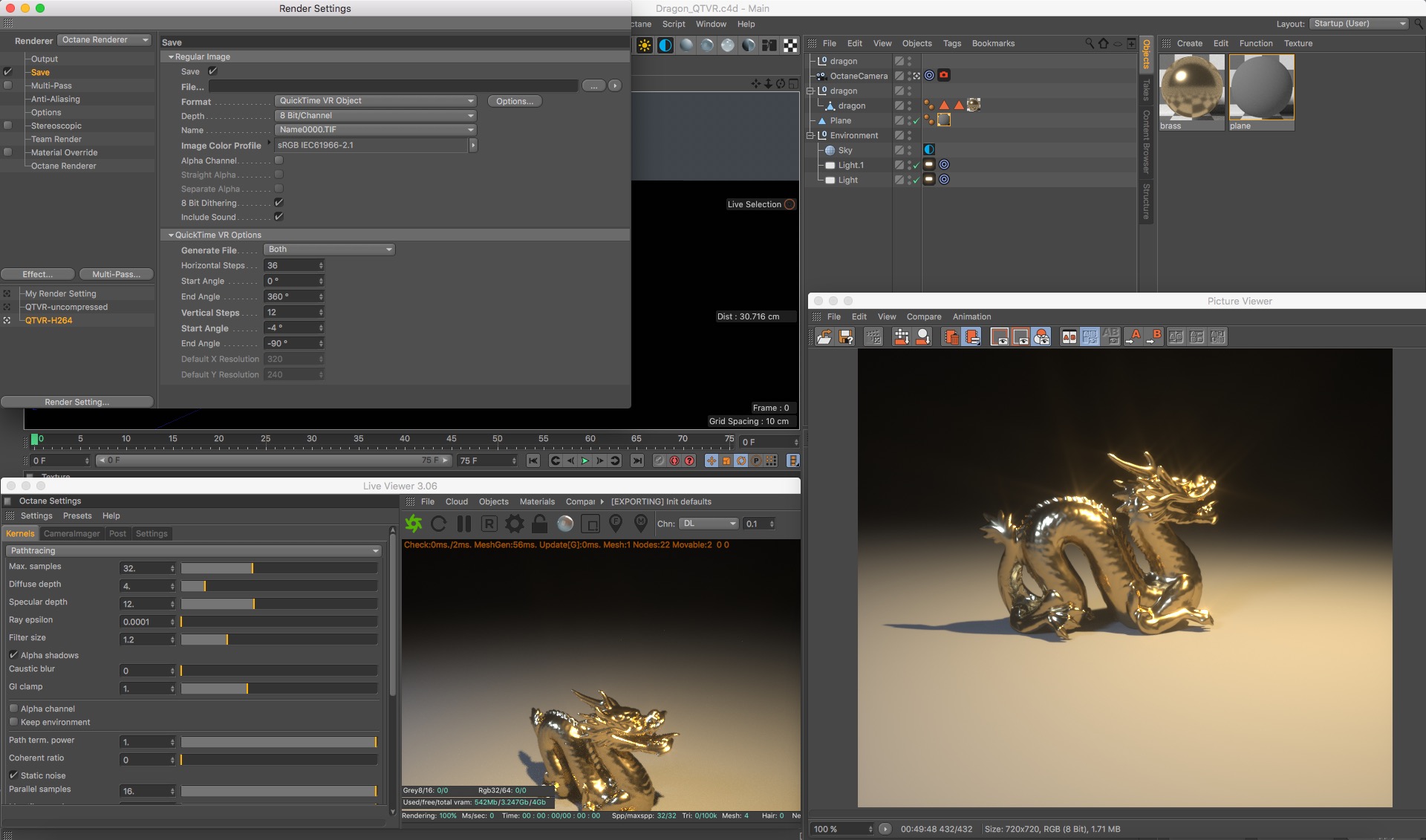

Posts: 10606
Hi RahiSan,
you could use the old QTVR Object feature to automatically create all the necessary frames:
Dragon_QTVRh.mov
(30.37 MiB) Downloaded 2847 times
Dragon_QTVR.zip
(1.42 MiB) Downloaded 226 times
You need QuickTime 7 Pro, I guess:
https://support.apple.com/downloads/quicktime
ciao beppe
