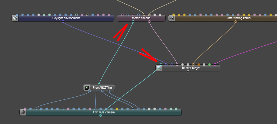

Hi dmiko,
Using coordinates from 3dsMax camera is hard to do.
You can use this luascript that captures the .abc camera coordinates with a SA thin lens camera.
Regards
Paride
Regards

Oh thank you,
that is exactly what I needed. Standalone is great also because it lets you use more Vram. In my case I have 5,4 GB vram available in standalone in comparison to 3,5 Gb in 3ds max. I wish this orbx node would be exported by default. It would surely make many newcommers to octane not scratch their head.
Cheers,
Daniel
