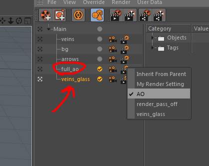

Cinema r18 octane 3.06 test4
full_ao take has a "AO" render setting which has "override kernel setting" enabled.
the next take, named veins_glass has its own render setting without "override kernel", but it still takes the "override kernel" from the full_ao take.
Other than that it runs smooth, thanks!

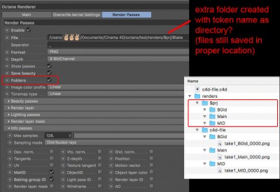

I've been using 3.06 Test4 in production for about 2-3 weeks now, and it's been pretty solid. I needed the motion blur support for Realflow fluids, so thank you for that, aoktar. Two things:
1) It seems that with the Folders option enabled in the Render Passes settings, if you use a token as a directory name, an extra folder with the token name will be created. Everything seems to save as normal in the proper directory though.
2) Is there support for Realflow wetmaps? If so, how can they be used?

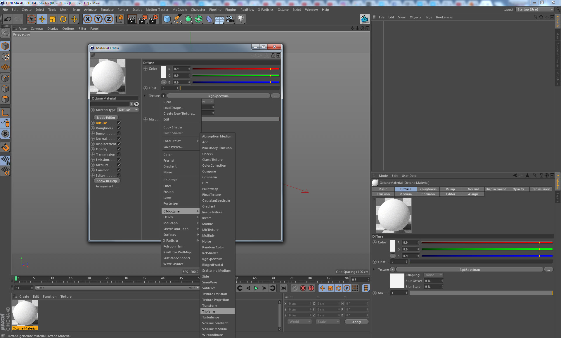

Hi Ahmet, thank you for this release. It's working great for me except for this weird thing about the triplanar node: when I try to apply the triplanar node to a slot already "occupied" (by an image texture or rgb node for example), Cinema freezes. Tried in different scenarios with different materials and it always happens. Is that happening just to me?
Domenico
