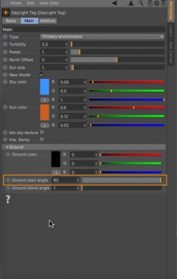

If you are in c4doctane, be aware that now the Sky tag has a new Ground option, where you can change the color, smooth out the gradient, or remove it by setting the start angle at 90°: ciao beppe
