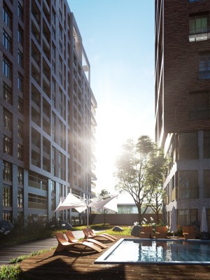

Hello!
Just a shot form pool view of residential project in Kazakstan. This is a draft, DL 1000 sample. Any comments are welcome :)

can share about your glass and water settings?

Hello Marvez,
I faked the glass with glossy material spec:1, rough:0, IOR:1.0, and I put falloff map to opacity, to fake the fresnel effect. (the project was very big, and model came from not very clean sketchup, I didnt have time to do double glass for all windows in the model. It is useful for fast glass)
For water - specular material with light blue tranmision, IOR 1.33 and Turbulance in bump (for waves). To enhance reflections I mixed it with glossy material, spec:1, rough:0, IOR:1.0 and same turbulance map for bump. For amount I put fallof map.

thank you for sharing your tricks ,
I wouldn't calling it faking - you achieved good control of mood and that's art

Thank you :) I agree, whatever it takes to achieve desired effect, result is what matters.
