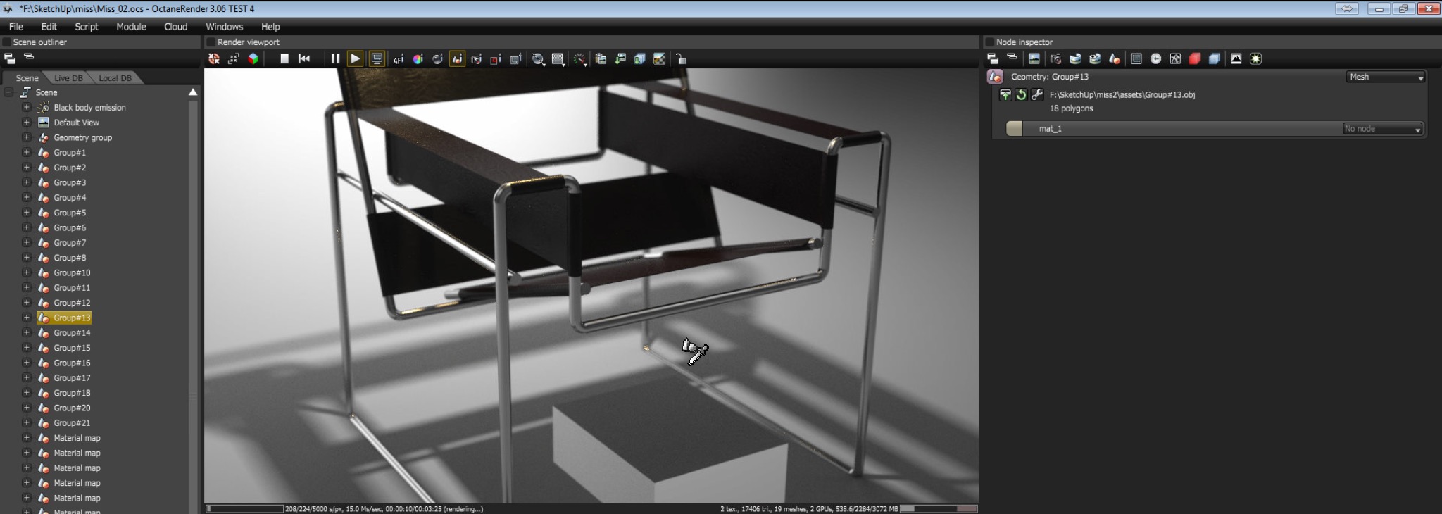

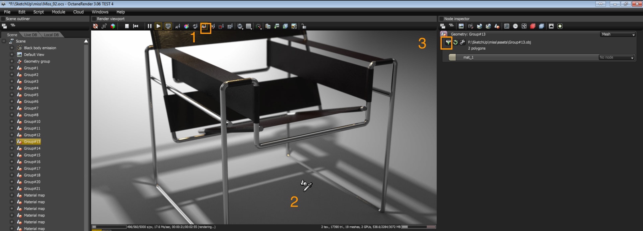

Hi lenreed,
in Sketchup, save a second .ocs with updated geometry.
In Standalone, open your original scene, then:
1. select the object picker
2. click on the object to be updated
3. click the first button in the node inspector to update the current geometry node with a new one.
4. find the conresponding geometry node in the new .ocs just exported from Sketchup, that's it, the selected geometry should be updated with its material assigned:
