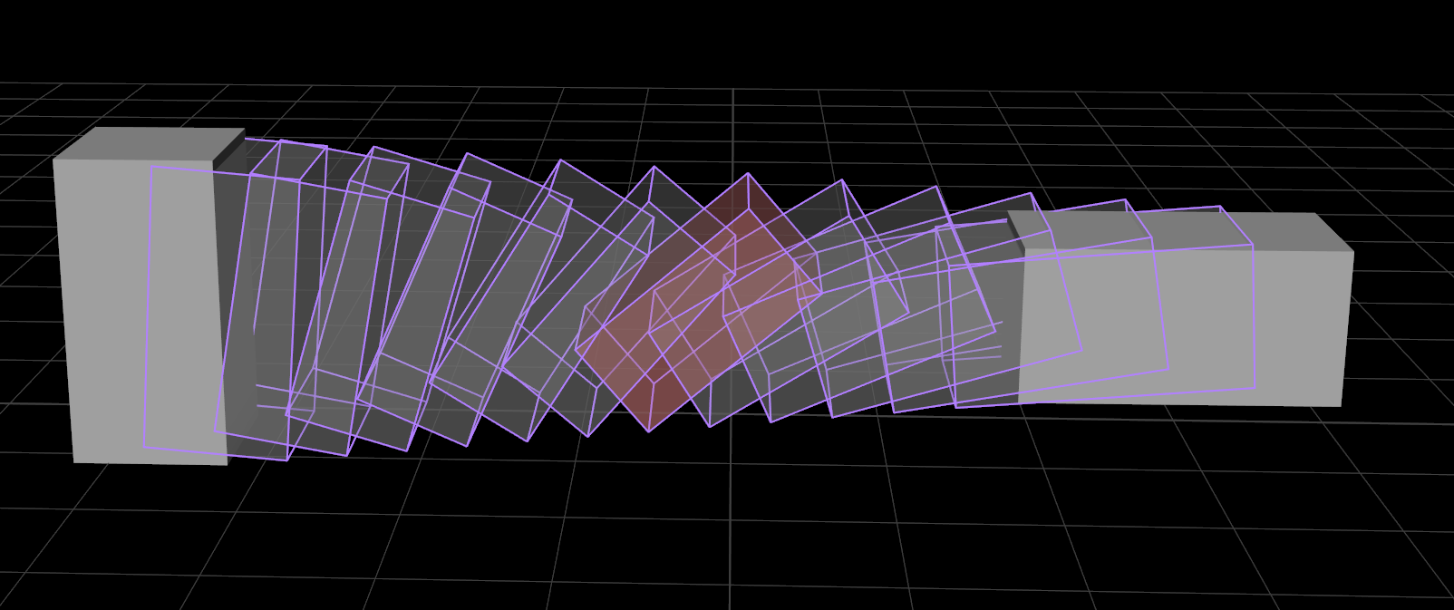

REALY TROUBLE: rotation object will change smaller when MB is on :evil:

renmaxhb wrote:REALY TROUBLE: rotation object will change smaller when MB is on :evil:
I guess you are using the symmetric MB direction,
this problem has always been there, this is not really a bug, this is because we are missing MB time sub-sampling in the plugin:
Currently in the plugin, for Motion-blur geometry is only sampled 2 times (= only 1 MB step per frame):
for symmetric, geometry is sampled once before and once after the current time,
so with only 2 samples the geometry at current time is interpolated between the pre-sample and the post-sample.
This is why it shrinks with rotation, symmetric must only be used with at least 3 samples ( = 2 MB steps ),
with only 2 samples we have this:
from geometry pre-sample  to geometry post-sample, vertex interpolation at current time give a shrinked object (red).
So "symmetric" shutter alignment must never be used in Maya,
more than 2 geometry samples per frame is not supported yet in the plugin,
but JimStar is working on it :)
This problem also happen with after and before MB direction for objects with fast non-linear movement, but is more obvious with symmetric.
