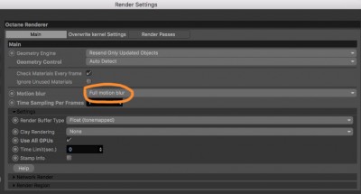

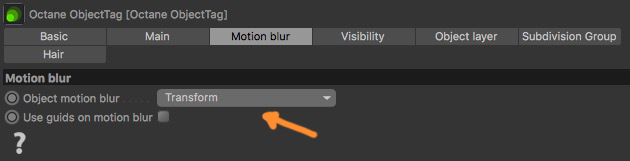

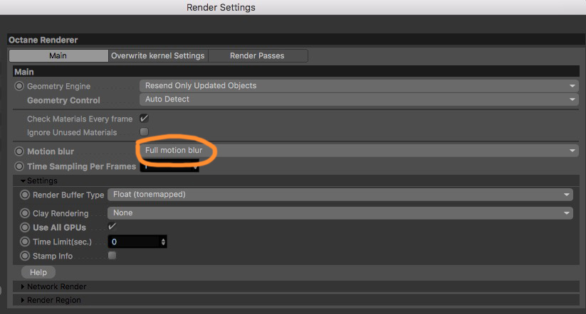

Default settings of Octane Render is set for this. When you open a new scene only thing you need is to put an object tag for objects.Kretschi wrote:Yes, now it works!
You need Full Motion Blut in the Octane render settings.. ..and an Octane object tag with motion blur on
Thanks again!
