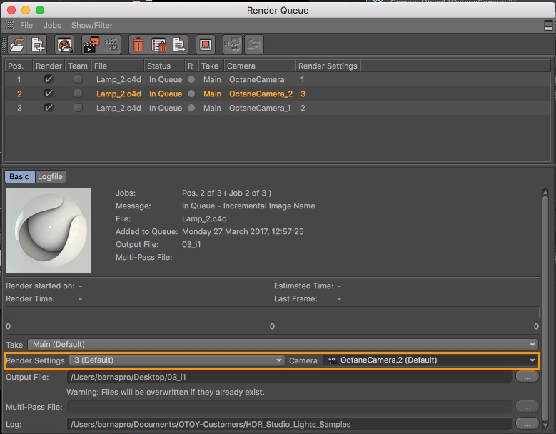

I have a NULL that contains 3 Octane cameras - front, left and right. I'm wondering if there is a way to render all of these out at the same time with the ability to change the resolution on each camera also?

just like c4d standard workflow, create three different Render settings with different options, then load the scene in Render Queue, duplicate it three times, and assign different render settings and different cameras, voilà:

Thats the one! perfecto! Thanks bepeg4d.
