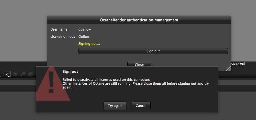

Are you saying that I should be trying to sign out using the stand alone app? I've tried both and get the same error, when using stand alone there's no trace of C4D in the Attribute manager of the machine I'm on. It's a weird instance really.

You showed an error window from Standalone: download/file.php?id=56366&mode=view
It says that another instances of Octane is still running. This means there is another progress which use octane core. I thought that can be an octane plugin which is still running same time.

As @aoktar said, you need to make sure no instances of either standalone or any application running an Octane plugin are running to sing out, regardless you do it from standalone or a plugin, the result is the same.
If there are no traces of running processes this may be a bug we haven't come across yet, but I'd encourage you to first update to the latest version of standalone and your plugin if you haven't done yet.
If this keeps happening, try restarting and trying again and please let us know how that works for you.
And again, you don't need to sign out every time, all you need to do is to close Octane so your license is released.
