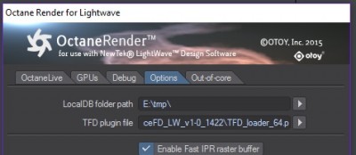

Anyway, are you sure that you have the right TFD plugin version (the 1419 one, that is the API used by the 3.06.0.0 plugin build) selected in the plugin options panel?

Great! Remember that if you update your plugin to the latest 3.06.0.4 build, you should update also your TFD plugin to the latest build 1422
