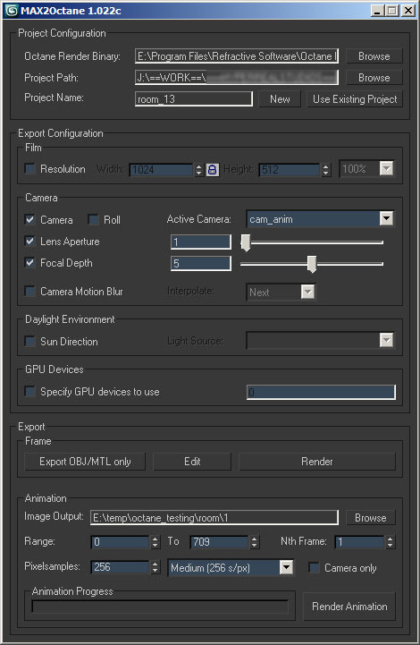

Having problems with animations from 3dsmax2009_x64.
I've been working on a room, exported it without the script-obj only initially. Shaded it, made running changes, reloaded the obj several times from the node inspector, reshaded new parts. The obj, materials and ocs file are all located in the same directory on a server.
Image output is set to local. All names of each file are named with room_(some#).obj or ocs.
Created a camera animation, camera is set to target. Ready to render to octane. Please see octane2max settings.
The obj being used in the ocs file is named "room_17.obj".
It imports, parses, voxelizes, loads textures and then i get this mesh load error. I opened the ocs file in a text editor to see if the mesh node was calling it a different obj name but they are the same.
Win7-X64 | Cubix 2x GTX 480 + QuadroFX 4600 PhysX | Dual-Quad W5590 | 12GB

jbeau3d wrote: The obj being used in the ocs file is named "room_17.obj".
the error is referring to room_13.obj. The obj and ocs are named from the project name.
anyway, try this:
- Press "Use existing Project"
- Find the ocs file to load (i.e: "Room_17.ocs")
- If theres no moving geometry in you scene check "Camera only"
- Check that everything looks ok by pressing "Render"
- Exit Octane
- Setup your animation settings
- Render animation
that should work
k

Thanks for the quick response. I've tried it per your settings and yield the same result... After the first frame I freeze.
yes, but I have replaced my OBJ file with an updated version as I made running changes. My ocs file
name is #13 but in the actual file I am using <linkedfilename>...\room_17.obj</linkedfilename>
