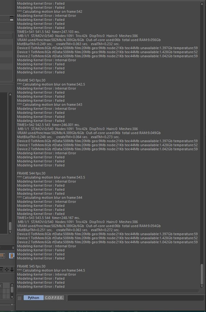

Decided to use it for a commercial gig, so far so good!
Thanks!
Update:[/color]
so currently I'm rendering an animation via C4D Render Que and I noticed some errors in console line.|
Here's my log and screen grab.
Is it because of my scene (C4D) or from Octane?
Thanks!

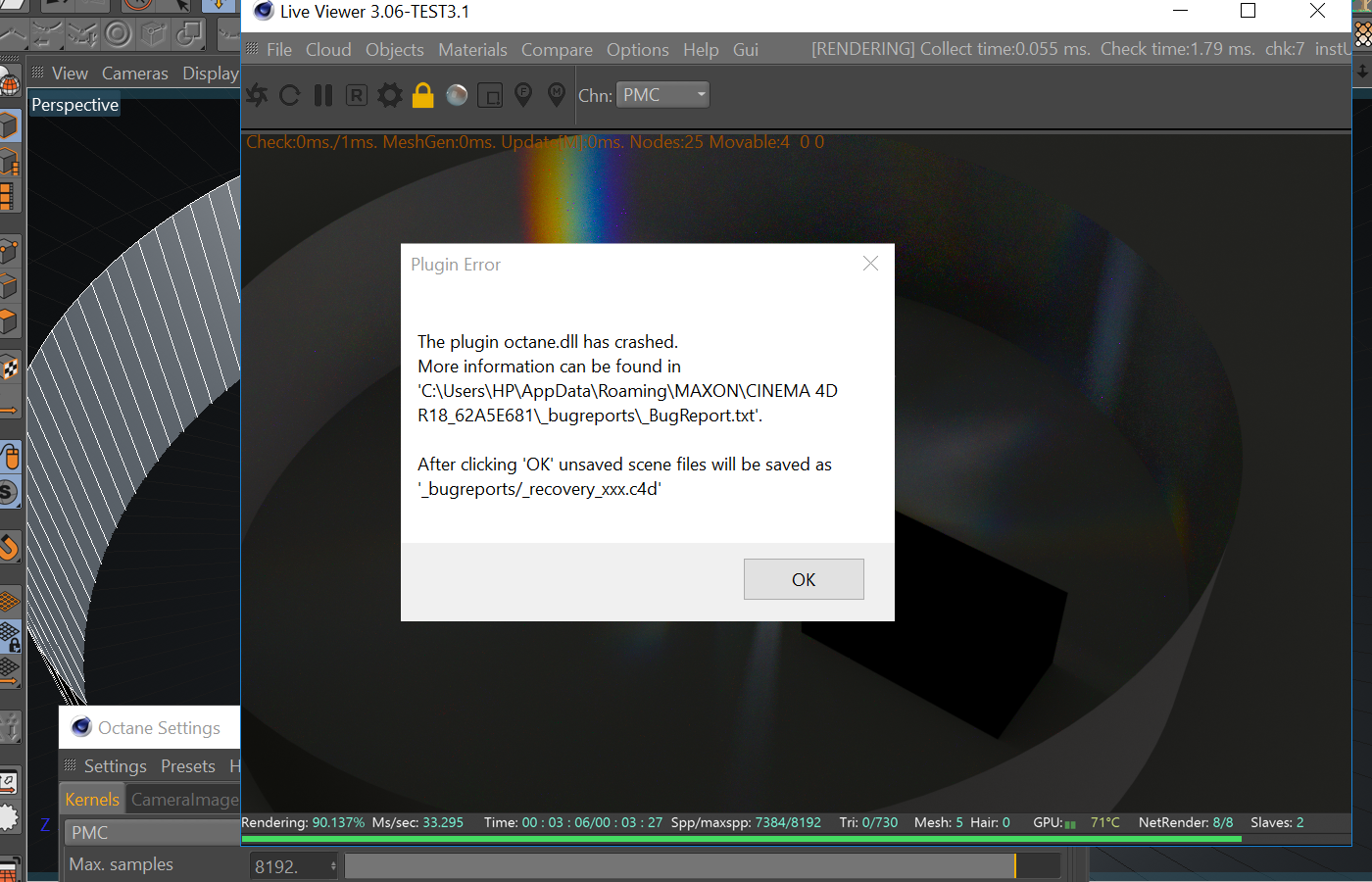

eyeonestudio
Posts: 335
Joined: Fri Oct 18, 2013 5:49 pm
Location: Seoul, South Korea
3.06 PMC Kernel : Not Stable
I make spectrum scene(Use DR-render, No Scattering Shader, No Fog).
An error occurs when the sample is almost completed.
Unfortunately I can not get logs. :oops:
3.05.3 is OK

zinogino wrote:Decided to use it for a commercial gig, so far so good!
Thanks!
Update:[/color]
Thanks!
i think C4D. Don't know any messages in Octane like that.

eyeonestudio wrote:3.06 PMC Kernel : Not Stable
3.05.3 is OK
Open bugreport.txt and check top lines. If it's like that: "octane.dll: Octane::RenderResultStatistics::progress...." so it's about renderer.
3.05.3 is OK
The attachment aa.png is no longer available
Ok... I got "Bug Report". ;)
_BugReport.zip
(26.2 KiB) Downloaded 351 times
C4D R2026 / Win11 / AMD TR WX Series / 256Gb RAM / RTX 5090 FE / 100GbE
Posts: 16068
Location: Türkiye
eyeonestudio wrote: Ok... I got "Bug Report". ;)
_BugReport.zip
Crash is on renderer. Do you mind to share your scene and description to reproduce?
_BugReport.zip
Hi Ahmet, this crash seems similar to the one noticed in the Maya Plugin and in Standalone (PMC octane core bug) ,
viewtopic.php?f=110&t=60027#p307121
Pascal ANDRE
Posts: 16068
Location: Türkiye
calus wrote: Hi Ahmet, this crash seems similar to the one noticed in the Maya Plugin and in Standalone (PMC octane core bug) ,
Maybe yes! Only thing i can see that's a crash on renderer not ended in plugin side. So that's why always asking for scenes and more information. To try and expecting to get same crashes on our system.
