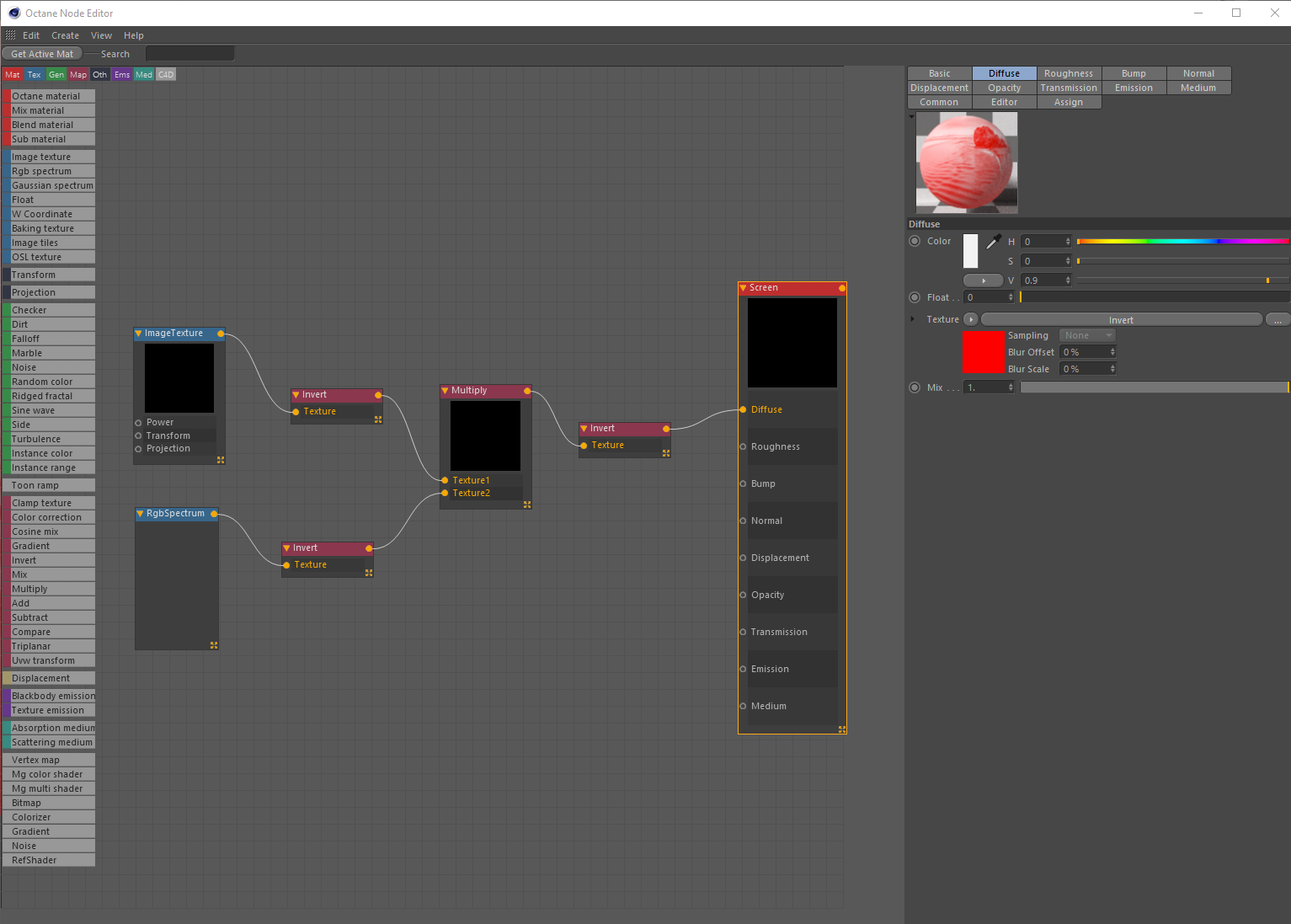

atome451, could you be so kind to provide an cinema scene with two textures mixed in "screen" mode.
I got two textures one is "asphalt" and the other is " white road marks", you said that "screen" should be placed in the amount channel, but there's no screen in octane :)
Thanks :)

pavel3d wrote:atome451, could you be so kind to provide an cinema scene with two textures mixed in "screen" mode.
Thanks :)
Hi
A while ago I made a few blending mode setups. There's much more than just screen. Check out the scene files. I hope that helps.
viewtopic.php?p=284085#p284085
Edit: also new 3.06 test release has this functionality built in so setups like this will not be needed in the future.

Here is a scene file with a texture using Screen Blend Mode:
Octane_ScreenMaterial.zip
(211.61 KiB) Downloaded 251 times
Nice but it's easier to do with OSL nodes anymore.

aoktar wrote:Nice but it's easier to do with OSL nodes anymore.
Cool! I don't know much about OSL nodes. How would setting up a blend mode work? I searched the forum but didn't find anything.
Posts: 16068
Location: Türkiye
Something like this, very simple.
https://en.wikipedia.org/wiki/Blend_modes#Screen
Octane_ScreenMaterial.rar
