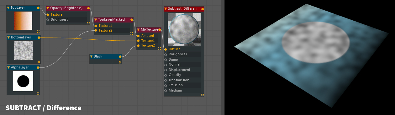

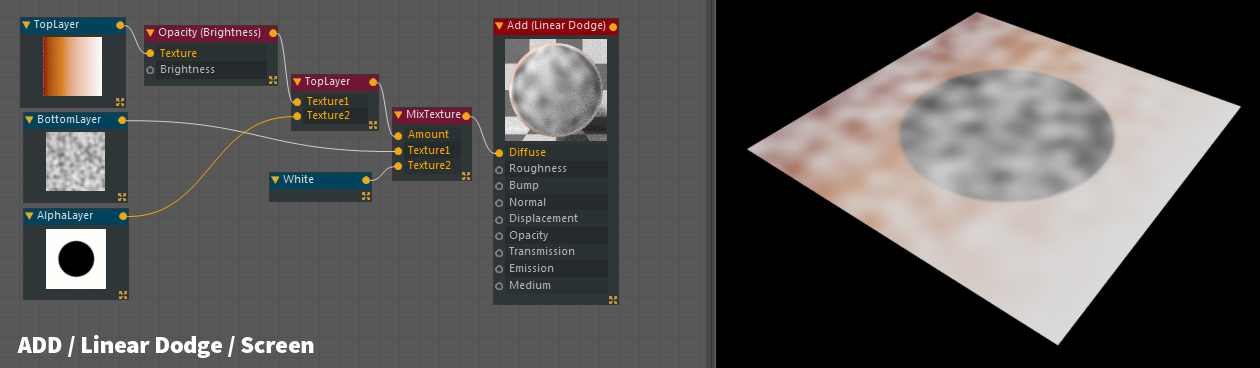

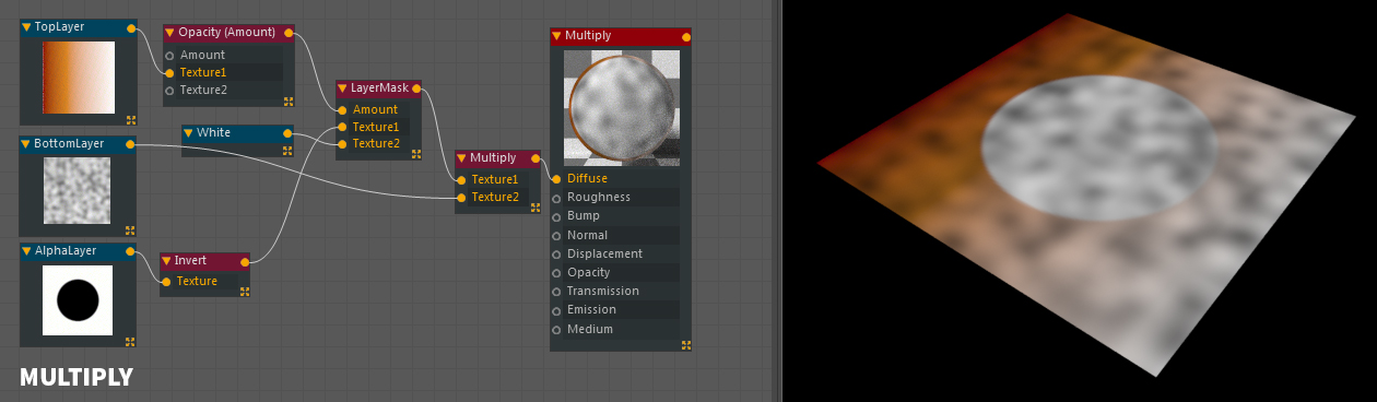

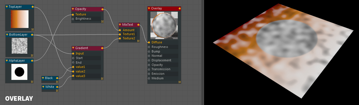

Hi
Yes, blendmodes are possible... to some extent :roll:
So far, i think only Color, Luminance, Hue and Saturation are not possible.
To get you started, here's how to do a few basic ones, including layer masking and opacity control.
( Just keep in mind that Octane is working in linear color space and it's possible to get values greater than 1 )
Regards
Milan
BlendingModes.zip
(160.82 KiB) Downloaded 252 times
