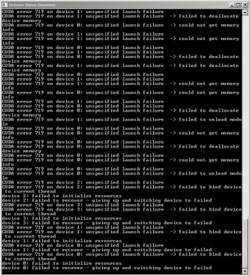

I had a problem when rendering with 2 computers.
Main computer (A) : TitanX + Titan
Second (B) : 4 TitanX
octane 3_04_3 - 4.25
I render a scene from 3dsmax with A+B and I have error message (see attachment) in slave deamon
I tried to render from Max with slave deamon with only one card after one, to see if one card have a problem.
I see a problem with the card 3.
When I diseable the 3th card all renders are fine (but slower...ahah)
I tried to render from SA with slave with all cards... no error !!!
Today I render same file from MAx with slave with all cards, but only with TitanX on A, all is fine..
octane 3_05_3 - 4.30
Could it be a problem mixing 2 different cards ?
Is there a problem with max ?
octane 3_05_3 solved some problems ?
net render problem

Hi hhbomb,
have you done these tests with the same file every time?
have you connected a monitor to the third video card is it?
have you tried using a small scene?
Regards
Paride
Regards
Paride
yes
yes, work fine.
yes, with smaller scenes with no texture there was no problem.
yes
yes, work fine.

Hi HHBomb,
could you kindly make this test:
Masters (A):
TITAN connect to monitor but deactive it in Octane
TitanX active in Octane
Slave (B):
4xTitanX active in Octane
remove all monitors
Run your test.
What happen?
