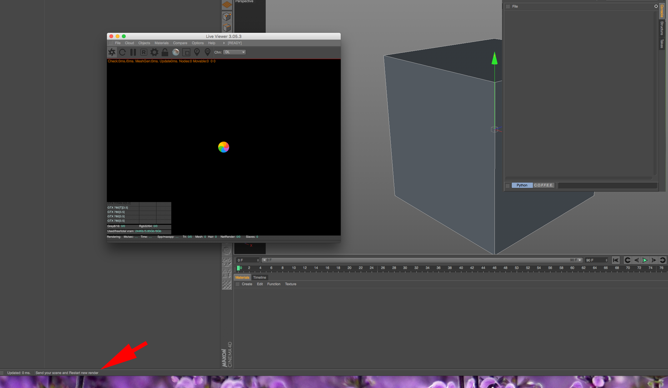

the other thing i don't know how can get the log file or the crash report because there is no one what happened exactly when i send my scene to render octane freezing and all what i see just the wheel and no info really in the console and i can't even open octane log when this crash happened how ever the only thing i can do is restart c4d and when i did and re open it i don't see anything in octane log arrrrrgh
please see the image it's just simple cube not large file.

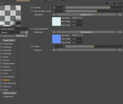

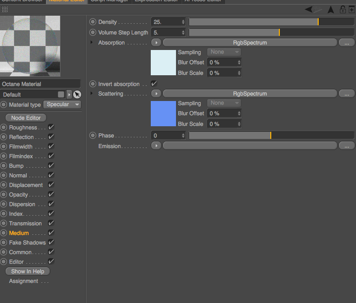

when i open the scene and sure what that mean i use only one material with MID and see the image please. the other thing is there is way too open this log file when the freezing happen because it's look like in Separated window

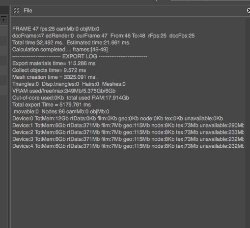

--------------------------- EXPORT LOG ---------------------------
Export materials time= 2593.653 ms
Collect objects time= 35.332 ms
Mesh creation time = 40.721 ms.
Triangles:0 Disp.triangles:0 Hairs:0 Meshes:0
VRAM used/free/max:350Mb/5.422Gb/6Gb
Out-of-core used:0Kb total used RAM:17.017Gb
Total export Time = 2870.337 ms
plugin already locked the result before!
the problem this happened random with different scene. and some time when i open the same scene that was freezing it's open and render fine

Ok i think i find something and i am sure this not the plugin problem i think for some reason my card unavailable and available randomly and if so i am not sure why this happen my drive is uptodate any i will keep searching. what you think about this? and i understand have a lot of thing to do so yah don't worry thank you.
