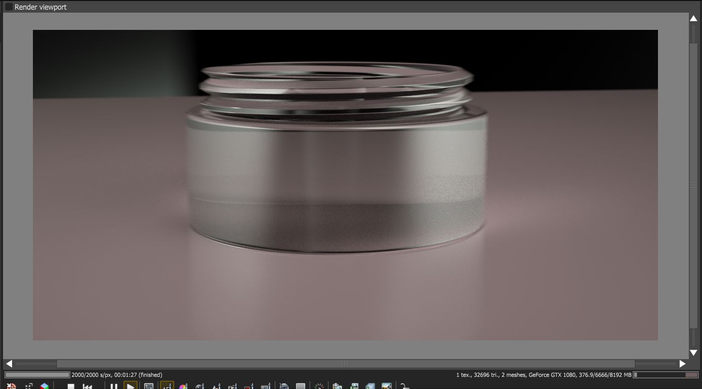

Tried to keep them as close as possible and ran them again. Had to export the Houdini file as alembic and imported into standalone.
I've provide both files with time references. Can you see or do a similar test and see what times you get? Maybe I'm missing a critical area that I need to change.
2;22 for Octane plugin
1:27 Standalone
Bottle_Speedtest.ocs
(52.08 KiB) Downloaded 309 times

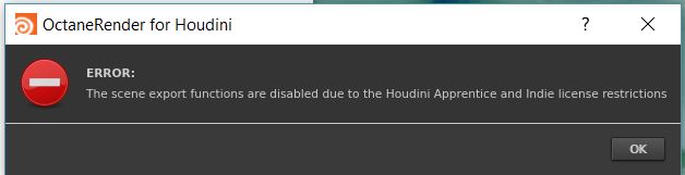

I tried to export the Houdini Indie file to .orbx and it gave me the following message. Are you able to export to a native octane file with Indie?
I used the right mouse click on the IPR window and tried to export from there.
Here's the file from indie.
https://dl.dropboxusercontent.com/u/618 ... ttle.hiplc
Yes, this is correct. Due to the Indie license restrictions, all the Octane scene export functions are disabled. Sorry.
Thanks,
-Juanjo

The restriction comes from the Houdini side due to the Indie licensing terms, not from the plugin.
The Houdini Indie version allows third party renderers, but only if the plugins run with two restrictions: the plugins can't export the scene data to files or to the cloud, and the render resolution while rendering sequences is limited to 1080p. These are the same limitations that Indie has with it's own renderer.
The same plugin working in the commercial Houdini versions doesn't have these restrictions.
