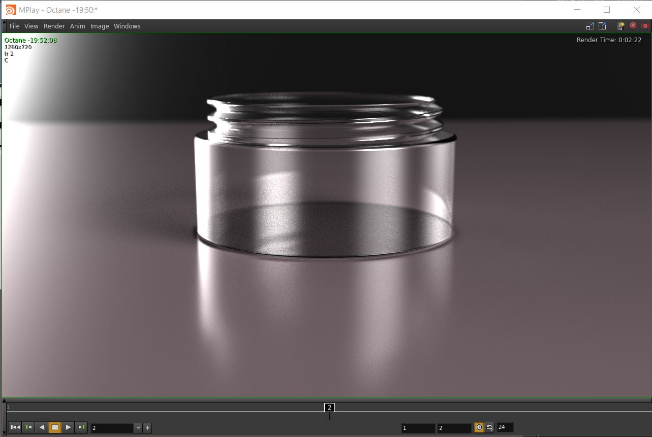

Tried to keep them as close as possible and ran them again. Had to export the Houdini file as alembic and imported into standalone.
I've provide both files with time references. Can you see or do a similar test and see what times you get? Maybe I'm missing a critical area that I need to change.
2;22 for Octane plugin
1:27 Standalone
1:27 Standalone

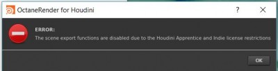

Hi Juanjo,
I tried to export the Houdini Indie file to .orbx and it gave me the following message. Are you able to export to a native octane file with Indie?
I used the right mouse click on the IPR window and tried to export from there.

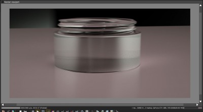

Hey Juanjo,
I just realized something. The reason my render took longer in in the plugin was because my IPR window was enlarged.
Ex1. IPR Window resolution of 800 x 450 = 39s (2000 samples)
Ex2. IPR Window resolution of 1595 x 811 = 2min24s (200 samples)
Didn't realize that the render size of the file (from one of the nodes) is overridden by the IPR window size. I have Octane plugin for Modo and don't believe it behaves that way.
Is that correct? What about MPlay? What is that relationship.
...Lord, so much to learn! Totally appreciate your help. Thank you.

Yes, this is correct. Due to the Indie license restrictions, all the Octane scene export functions are disabled. Sorry.VISUAL360 wrote:Hi Juanjo,
Here's the file from indie.
https://dl.dropboxusercontent.com/u/618 ... ttle.hiplc
Thanks,
-Juanjo
