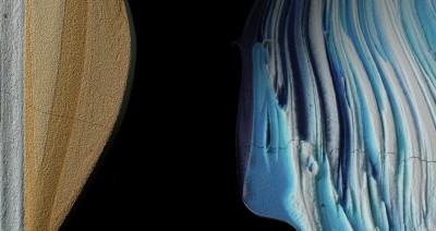

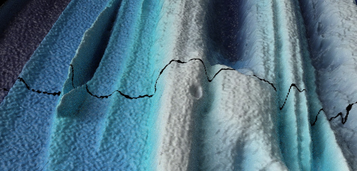

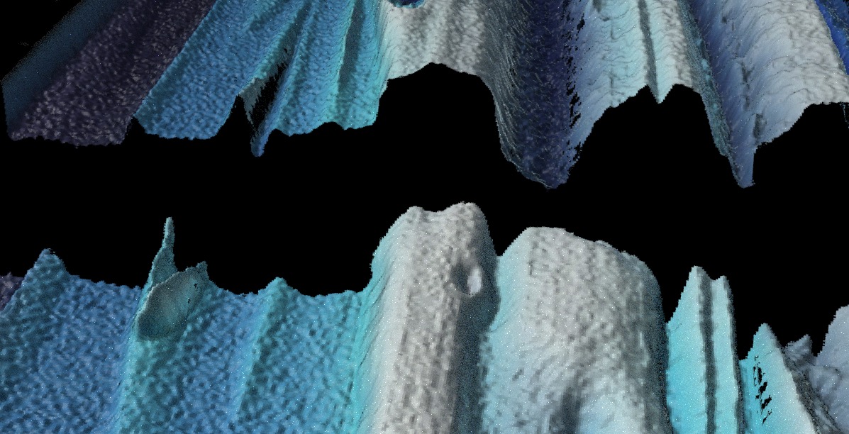

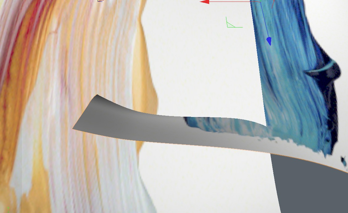

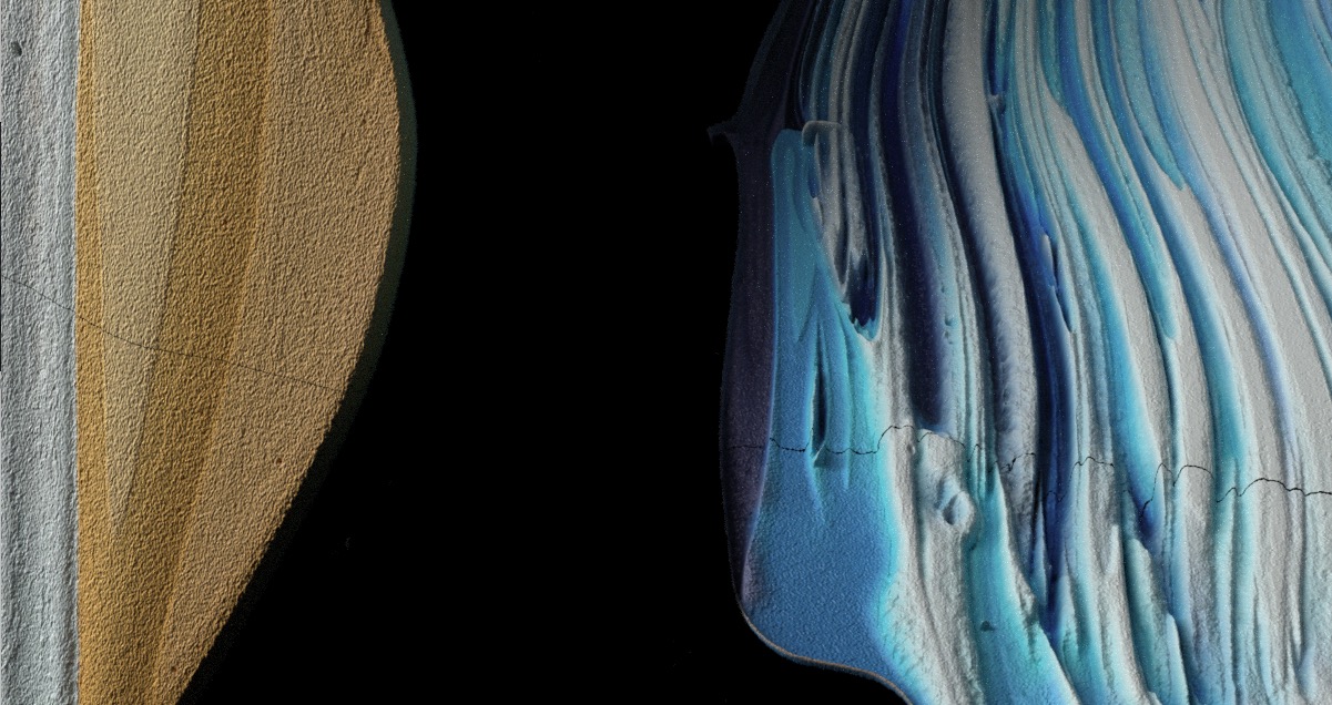

I am having an issue with two planes that intersect and create a thin black line in areas the alpha is making invisible. I have tried adjusting ray epsilon and this only occurs when displacement is on. When increasing ray epsilon the gap increases. Attached below some screen grabs with descriptions to illustrate. I know it is very small visibly however these images will be viewed at high res.
Using the latest stable octane plugin and standalone.
Thanks in advanced for any ideas/help.
Ray epsilon increased
close up of gap
close up of gap
Showing thin gap in rendered image
Image showing C4d viewport of intersecting planes

Thanks for the reply. The geometry isn't too large approx 100cm I think. The second screen grab in my first post is the ray epsilon value set to the minimum it will go. Is there anything else that can be done?
