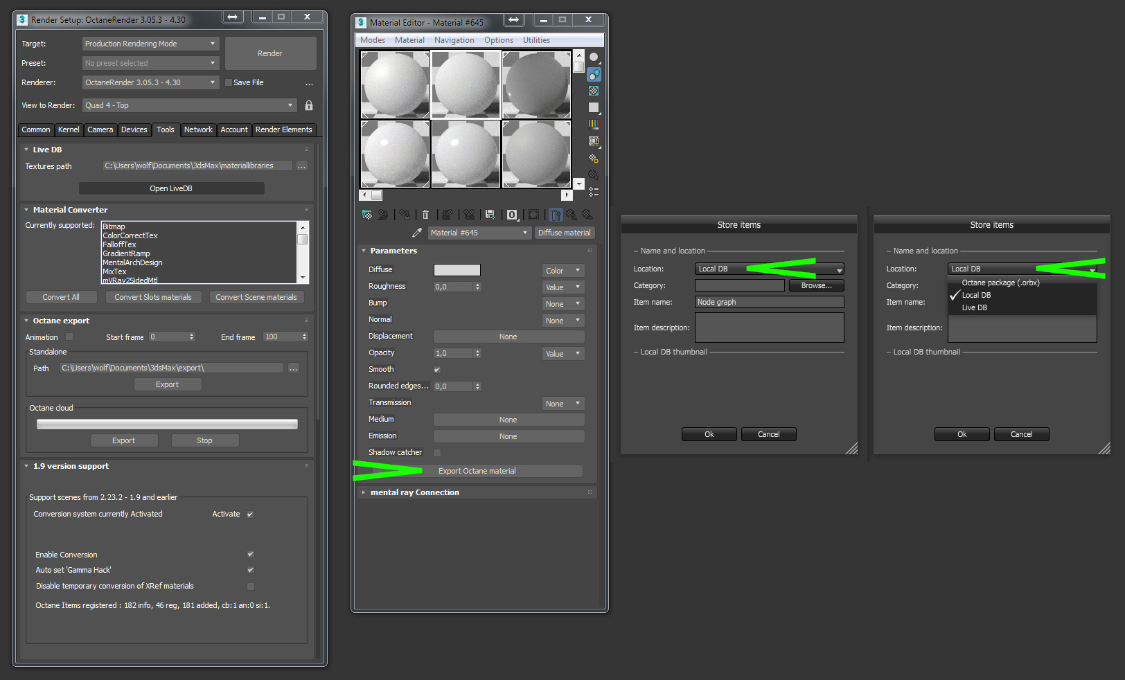

I have one more question, because there is no real documentation of the Plugin. I found an option to export Octane-Materials from Max, where/how can I import materials from my LocalDB or LiveDB?
paride4331
Posts: 3994
Hi TFrank,
LiveDB import
https://docs.otoy.com/#3ds-max-v3-using ... er-localdb
LocalDB export (screenshot)
Regards
Paride
