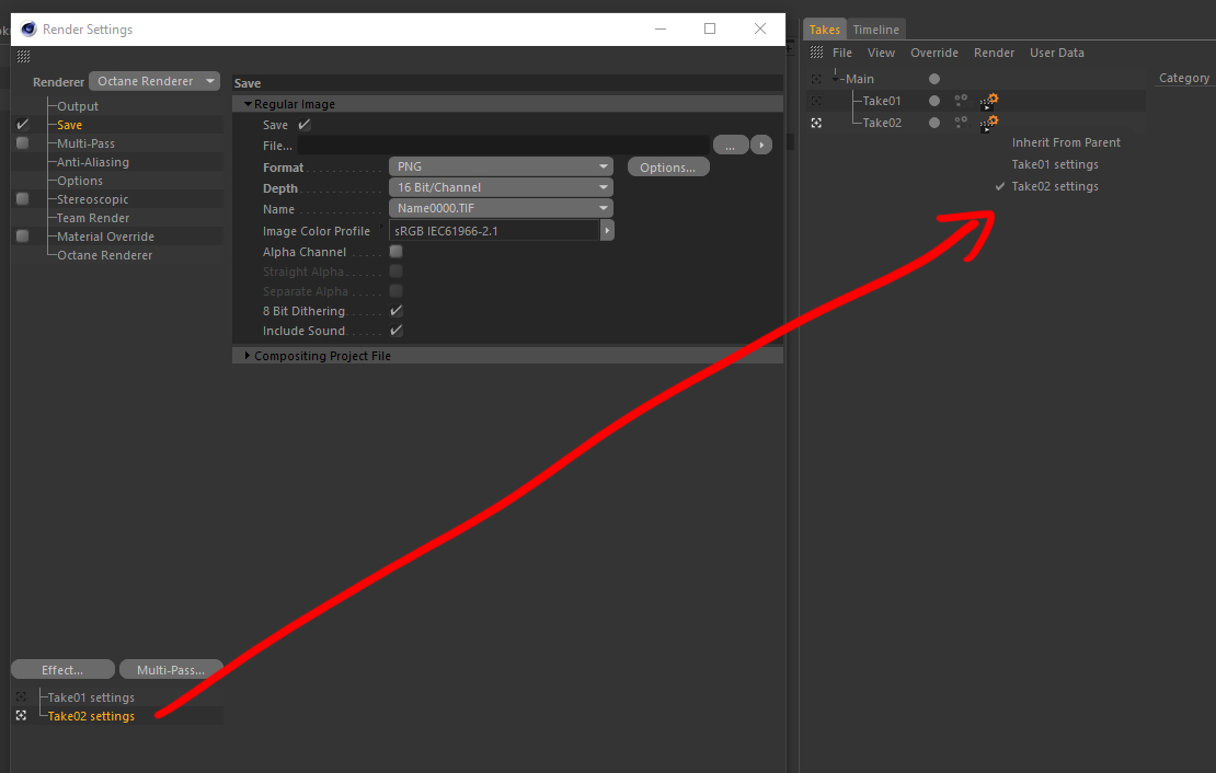

I recently started using C4D's new Take System to render multiple frames with different textures. However, I am having trouble with the output files. Each time a new file is rendered, it takes the same name as the previous render, thus overwriting it. Is there anyway to get around this with Octane?
I attached a screenshot of my export settings.

Started playing with the take system recently too. Haven't quite got my head around it yet, seems a bit more complicated than photoshop layer comps. But I think i managed to get over the file name problem by using file name tokens. Try adding $take to your filename in all the output paths.

For every take you want to render you'd have tom set up a different render setting and then select this setting within the take settings dialog. This will then use the file path you set up for each take.

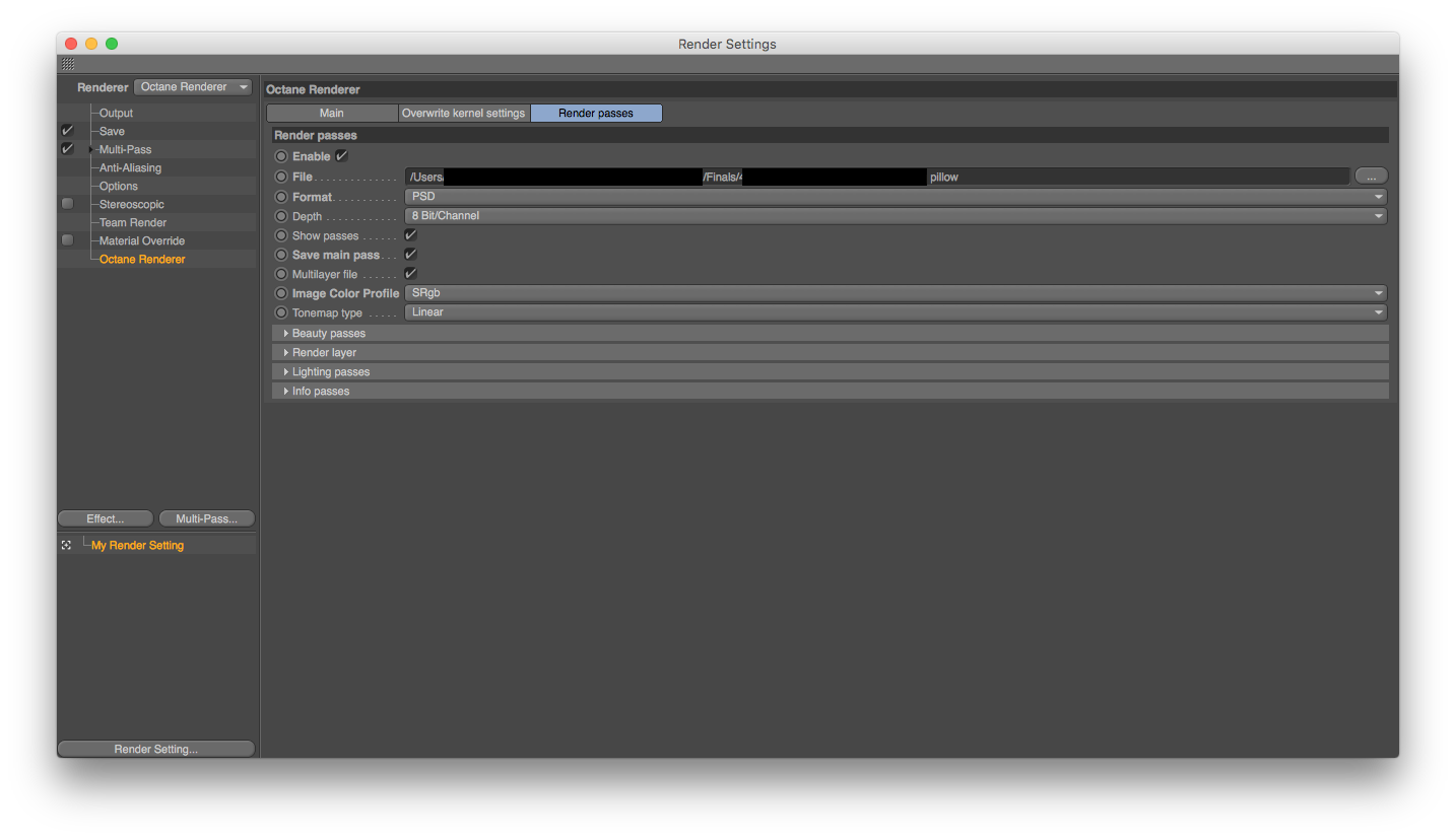

One thing I noticed, is that when you type in a path file in the regular Cinema 4D save path - Cinema 4D will create this folder if it is not already there. This is incredibly helpful and a huge time saver.
I noticed when rendering through the Octane Multipass - if the folder doesn't exist, Octane won't create the folder. It would be stellar to have the behavior match C4D's. The folder should be created if it is not already there.
