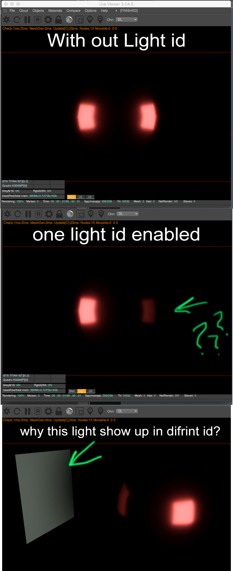

Hi guys, I have a scene with a sphere (looking at it straight on) which has a reflective material (Metallic) with one light on the right and the other on the left
Now if I enable to light passes for each one (Light ID 1 and 2), it technically works, however they are not fully invisible... they are off but I can still see a "low light white" reflection of them in the material... how do I get rid of that ??
i found small work around if i turn the Light Opacity i get the result i am after but why the light show up anyway in id not for him i am really wandering please find the scene file.

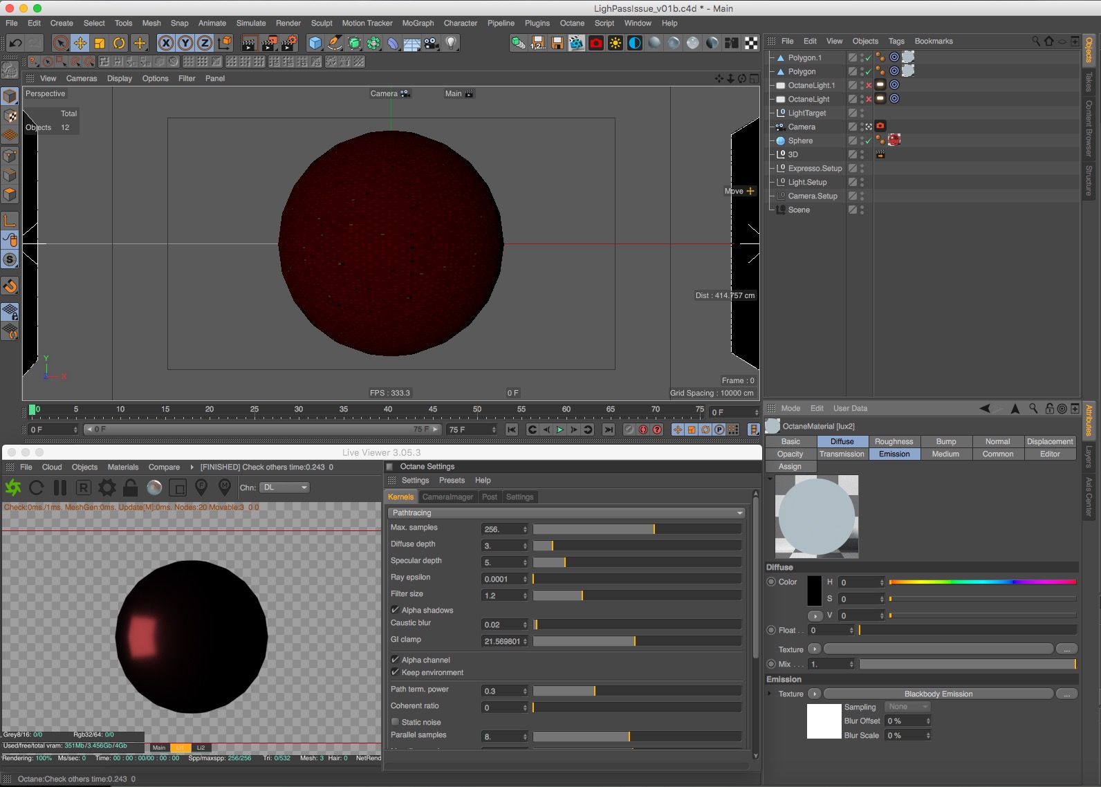

Posts: 10623
I guess that the issue comes from the diffuse part that is reflected.
Look at this other version with a polygon emitter and diffuse emissive material, and Diffuse color set to black:
LighPassIssue_v01b.c4d.zip
(80.34 KiB) Downloaded 260 times
ciao beppe

Beppe.... You da man! Thank you.
This does the trick - awesome!
Why didn't I think of this... :lol:
