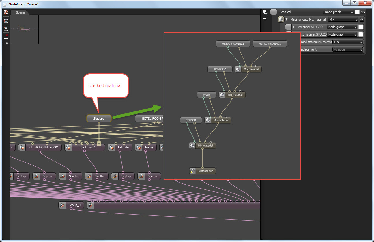

It's more clear now and that's why i want a sample scene always. Your message does not contains any words about usage as stacking. That's not directly a image sequence problem.
Please check the attached picture for exported Octane Scene Graph. Here we have a special material tree which have stacked materials for each objects. And these are not getting updated until a change on mesh data or material data. So that's about a missing detect/update problem for this system. It's a bit harder and longer than normal material updates. It will require full update for related materials and current mesh. I hope this is clear?
