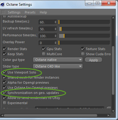

What's your those two parameters? Synched updates OFF for some glitch in multi viewports on OSX. But this is not working well after some revisions on plugin.
- Attachments
- a2.jpg (52.53 KiB) Viewed 3800 times
Viewport Solo is ON
Sync on geo. updates is OFF
(I also noticed on mine MultiCore is ON, yours is OFF. Should this also be off?)
Windows 10 - 64GB RAM - Cinema 4D R20 - RTX 2070 x3
Most critical is synch. on geo. updates. Try with ON and also be sure that you deleted unnecessary plugin files in c4doctane directory. As wrote in readme.txt.sdanaher wrote:Viewport Solo is ON

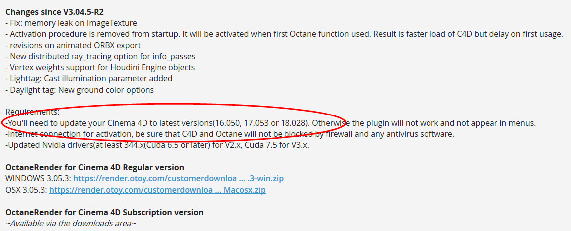

So you didn't updated C4D as. In release notes. Running R17 builds in R18 can cause problems.sdanaher wrote:Funny you should say that. I'm on R18 but Octane won't load unless I have R18 AND R17 plugins in the c4doctane folder.
aoktar wrote:So you didn't updated C4D as. In release notes. Running R17 builds in R18 can cause problems.sdanaher wrote:Funny you should say that. I'm on R18 but Octane won't load unless I have R18 AND R17 plugins in the c4doctane folder.
No. Its not because I didn't read and understand the notes, its that Octane WONT LOAD unless both R18 and R17 plugins are present.
I was on R18.020, I've redownloaded Cinema and updated to R18.041 as there must be some compatibility issues with that build.
R18.041 and Octane now work with the single R18 library. I hope this was the cause of some of most of the issues...
Hi,sdanaher wrote:No. Its not because I didn't read and understand the notes, its that Octane WONT LOAD unless both R18 and R17 plugins are present.
If you check image there is some notes about requirements. It's not about me. Plugins has been compiled with 18.039 and older Cinema 4D will not load this build. But funny that built for R17 can be loaded in R18. I've added some codes to load just related builds.
Let's see what happen on you with correct builds.
