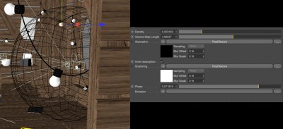

The next question I have is volumetric light, I followed a tutorial where they told me to put a sphere around my camera, and then that sphere needed to have a fog volume texture applied. Find attached the setup.

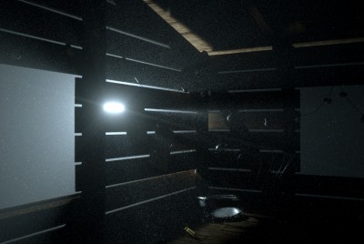

Also find attached a screen of how the volume light is working. So my problem is that I want more dense beams of light coming through those gaps, but when I up the density of my scattering medium, it just makes everything darker so more particles the darker it is. I thought it would just affect the fog as it's illuminated.

Hi JoeHunter91,
now we have the environment medium node, please look at this example scene:
viewtopic.php?f=33&t=53977&p=274660&hil ... ys#p274660
In general, you have to remove the Invert absorption option or change the color to white, otherwise all the light is absorbed. But the most important value is the Thikness value, that works in meters and is relative to the maximum dimensions of the scene, so it must be corrected every time, and there is not a default value good for every condition.
