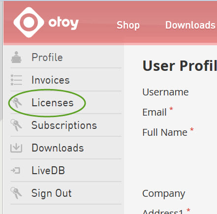

This page. It will show activation status. Pls check and let me know if that's deactivated or not on quit. Some users are having this issue about unproper quit of C4D. And stays on background. I don't have exact idea why but my suspections around some network blockage on exit. Also is it closing and diasppearing from task manager if you close LV before quitting?

aoktar wrote:This page. It will show activation status. Pls check and let me know if that's deactivated or not on quit. Some users are having this issue about unproper quit of C4D. And stays on background. I don't have exact idea why but my suspections around some network blockage on exit. Also is it closing and diasppearing from task manager if you close LV before quitting?
Yes it remains activated upon exiting. Only way for me to swap devices is to enter C4D and sign out via octane options then exiting.
