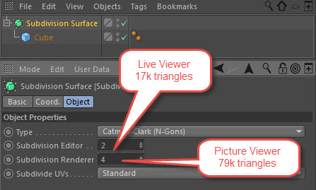

You understand wrong apparently. I afraid to see wrong words are spreading. Please! That's not about Octane don't love somethings, etc.. It loves everythings if you love. It just about different polygon counts. It worked on you because you've fixed polygon counts by converting to polygon. As document says that LV vs. PV is like Editor/Render. Different counts of triangles, hairs, etc.. on PV and hitted to wall of VRAM or renderer. So making same parameters as in image will fix same triangle counts.vchiline wrote:I converted all parametric objects to polys and it appears to have solved the problem - Octane didn't like the parametrics on those trees..... my scene now has 3 million polys, but renders out!

Live viewer displays the mesh that's meant for the live preview, as you showed in your screenshot with the subdivision object - 2 vs 4. I didn't have any of those objects, only parametric trees, which I didn't see something like that... a little like a parametric sphere, cube, etc. Perhaps at render time something gets converted, and does like the subdivision object, but it's opaque to me (or it's buried somewhere in the settings of the object). I'll check it out.... but I agree - 9.5 times out of 10, it's my lack of knowledge the problem.
