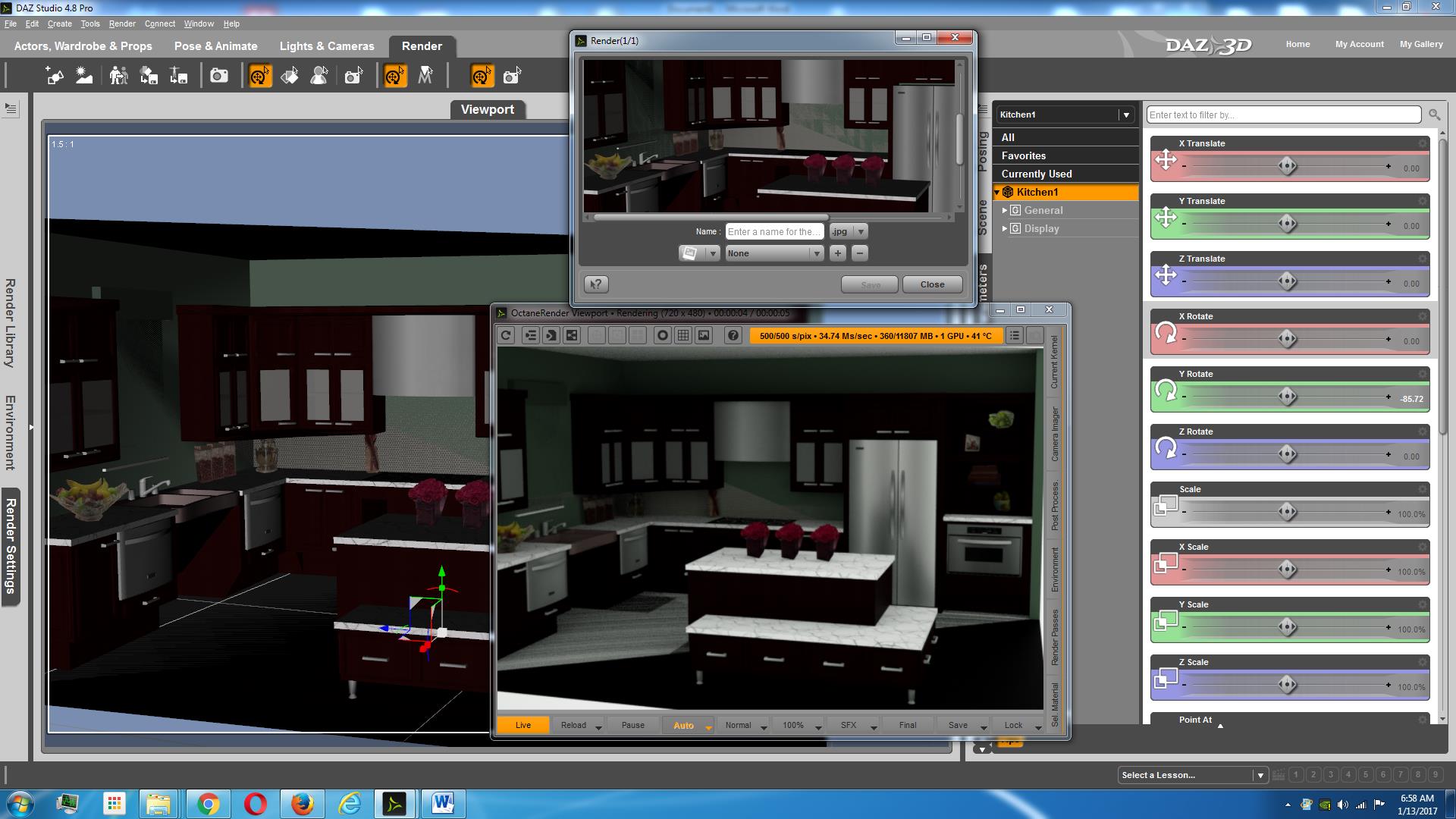

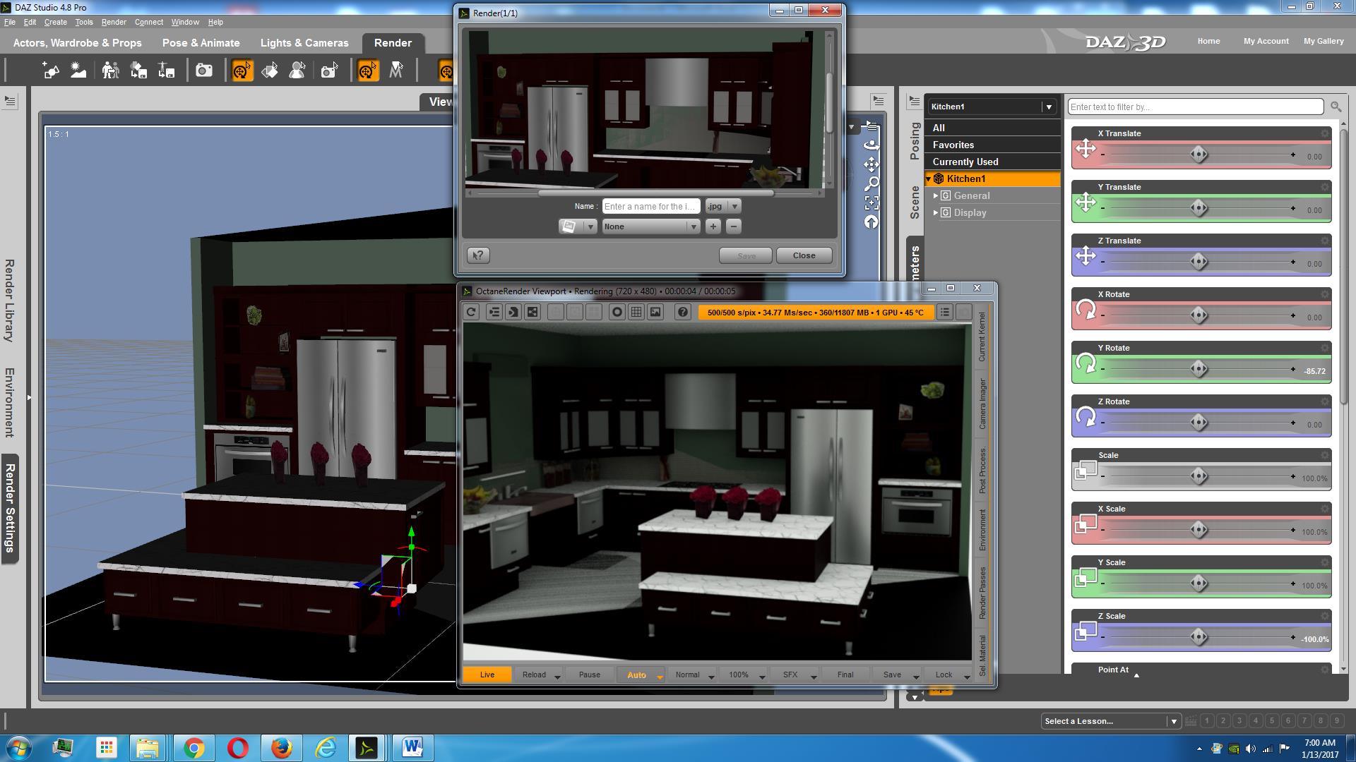

Here is a weird one, I looked on Daz forums about mirroring/flipping an OBJ, and the forum poster suggested flipping Z-Scale in Parameters from 100% to -100%.
When I do this, the OBJ flips in the DAZ viewport, and renders natively in DAZ as flipped, but in Octane plug, even if you refresh, move, close out and re-open, etc, it is not flipped.
What the flip is going on.
Thanks!
Z Scale for OBJ @ 100 (normal)
Z Scale for OBJ @ -100 (flipped).  Not matching in OCDS
I checked the plugin code, and for a reason that is not obvious, any negative scales were being multipled by -1 (ie. being made positive again) - causing the flip to not work. I have removed this code in the version below - can you pls test it? The de-negative scaling code may have been there for a reason, so removing this code may have adverse effects in other parts of the plugin - so pls let me know how you go with it.
