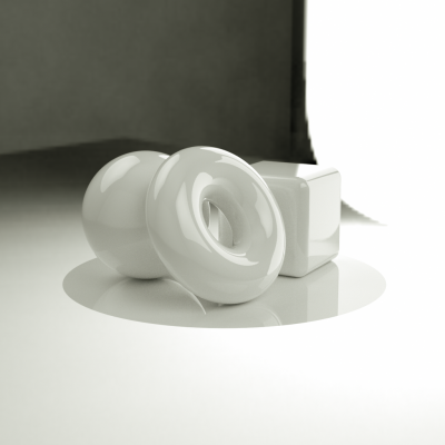

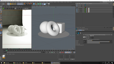

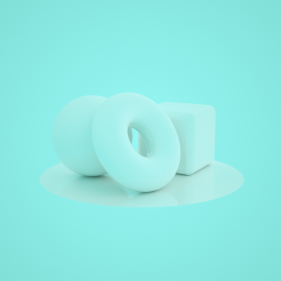

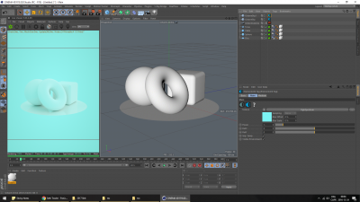

i'm on Octane Render 3.03.2-R5 and having some issues, i dont know if its me not catching a new settings, or the software itself.
So i'm triying to light objects (a scene) with an HDRI then hide the HDRI and show another image/color on background (but not only background, on all around , its for VR content).
In the previous version of Octane Render i had 3 options on the Environment Tag it was more versatile for me cause i could chose betwen two OctaneSky wich one will affect reflection, background...
But now, if i put two OctaneSky, one with an HDRI Imp. Samp. Enabled Visible Environment Disabled and the second OctaneSky with an RgbSpectrum Imp. Samp. Enabled Visible Environment Enabled, the RgbSpectrum will affect the scene... And i woold just show the RgbSpectrum on background.

The RgbSpectrum Environment Tag with Visible Environment enabled affect all the objects... even reflections

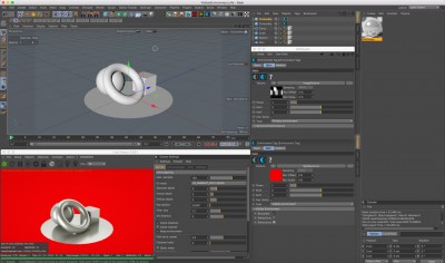

Hi dzdiode,
you are working with a very old version, please upgrade to the latest version and try with the attached example scene:
VisibleEnvironment.zip
(409.82 KiB) Downloaded 206 times

bepeg4d wrote:Hi dzdiode,
ciao beppe
Hi beppe, thanks a lot for the scene, and you are right, now that i have the lattest build everything is good. I didnt know about the new build, i come here not often.

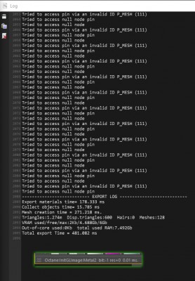

Guys, by the way, what about the InitGLImage message en on bottom left of the screen, it shows this message when i try to send a scene (not always but quit often) and it seams Octane stop working. After that, i cant send a scene, even if i close the project and reopen it. I have to close C4D. And when i close C4D i have a message Wait until Export! (assuming its Octane message) so i have to end C4D process from Windows task manager...
I did a screen capture of the bottom message and a part of Octane Log shoing a lot of ID erros. Im i doing something wrong?

This message show a texture rendering process in materials for opengl. Other messages will not cause any problem.
