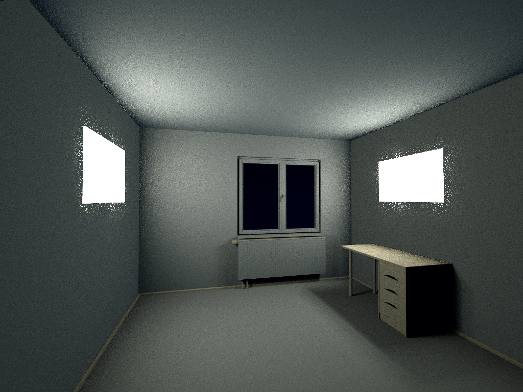

This is simply great. Here an quick and simple test with my new project.
We can save and share materials, lightemitters.
You make an very good job. Now i can´t wait till 2.3.
