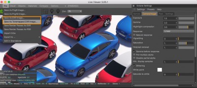

internally OctaneRender always work in linear mode, as said, the camera imager is like the post effect. When rendering in Live View, you can save in both linear mode or Tonemapped mode:

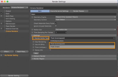

in Picture Viewer for final rendering, you have to choose the output type, Tonemapped or not:
in practice, in the Camera Imager you can choose the Linear response curve mode with Gamma 2.2 or choose a different response curve, but always save the final result as Linear untonemapped.

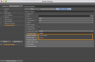

The same things happen for Render Passes, you have to specify if you want to save the final result in Linear or Tonemapped mode:
