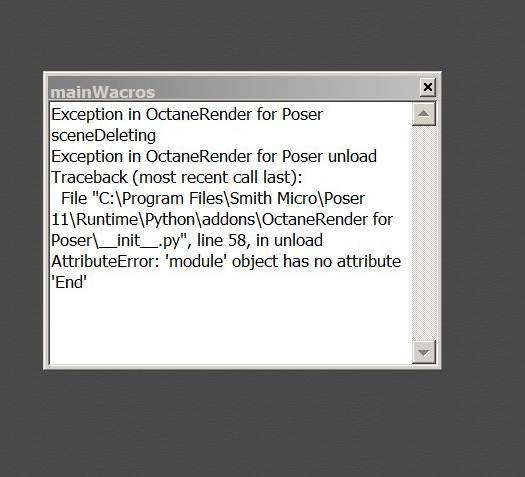

okay deleted nvidia driver and reverted to old one 331 that came with computer.
1. Doesnt crash on Poser start up.
2. Octane not in Poser menus.
3 Getting this error attached; { apparently pointing to a folder NO LONGER even on the computer }
gold
Posts: 250
Joined: Tue Mar 12, 2013 11:02 pm
Note Add:
Error above pointing to folder NEVER on the computer. I don't have Poser 11.
So Octane 3 must have created that error folder, correct? Why?

Hi. This looks more like a driver problems than Octane or Poser.
Does Octane Standalone (the latest 3.05 version) work on your PC?
Paul

well I reverted to old driver 331, now. So for sure wouldn't work right?
face_off
Posts: 15830
Location: Adelaide, Australia
No, Octane needs a later version of the Nvidia driver than 331. Pls install the latest and see of Octane Standalone works.
Paul
