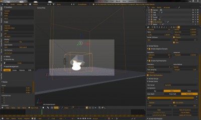

This happens using the integrated Blender-Octane-Version (2.78a):
When rendering a smoke/fire-simulation that used "adaptive-domain", octane resizes the flame (looks like).
In the viewport - and viewport-preview everything is fine- but when rendering an animation it seems octane does not handle the adaptive domain correctly.
1. Open the blend
2. Select the Smoke Domain
3. Go to the physics-tabs and scroll down the smokeoptions
4. Enable "Smoke Adaptive Domain" checkbox
5. Play the animation for around 10 frames, then STOP simulating
6. At the last simulated frame press F12 to see what happens
System: Win7 64bit, GTX780, 32GB DDR5 RAM, NVidia Driver 375.95, Octane 3.04.4, Blender Octane Edition 2.78a, Octane Server TEST3

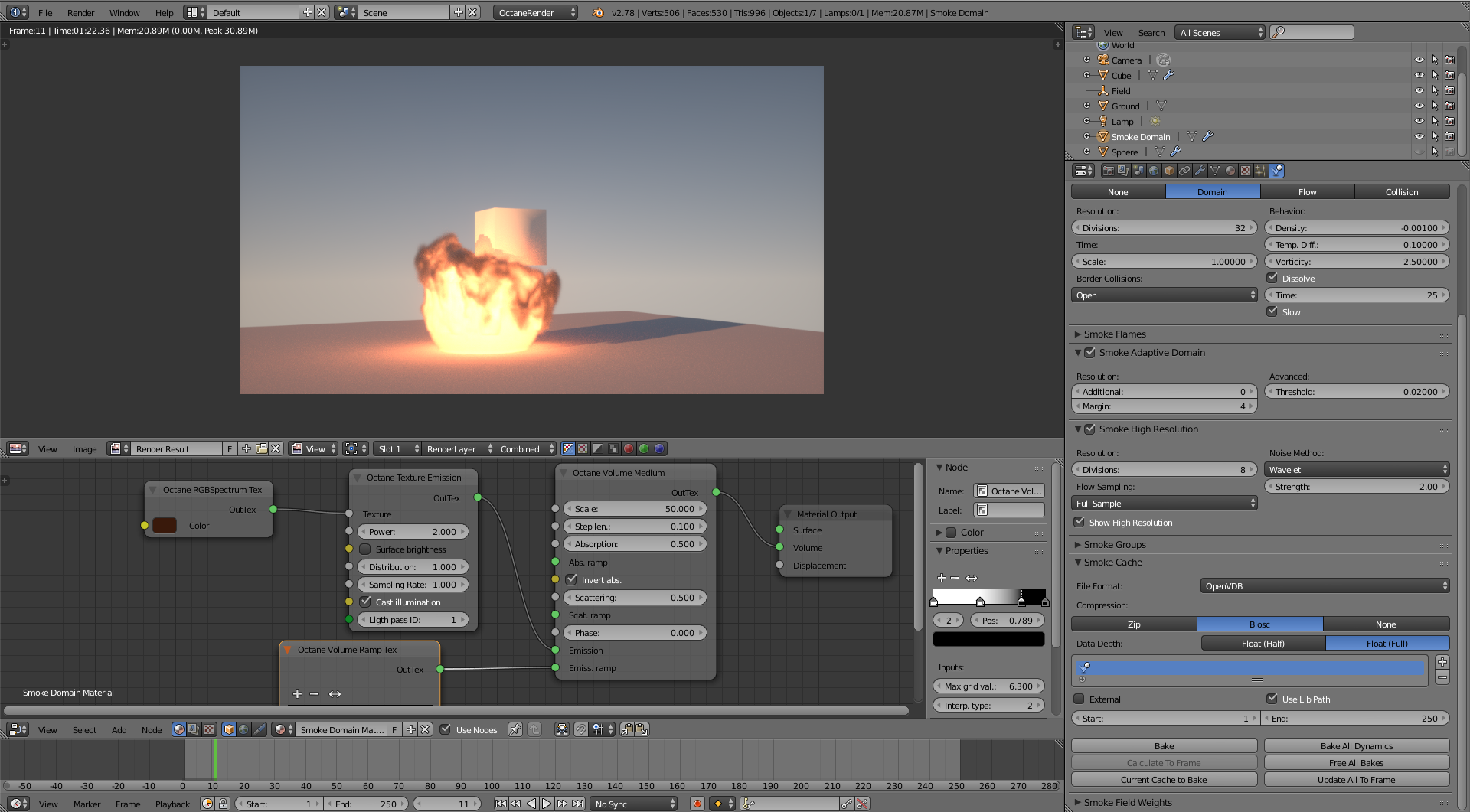

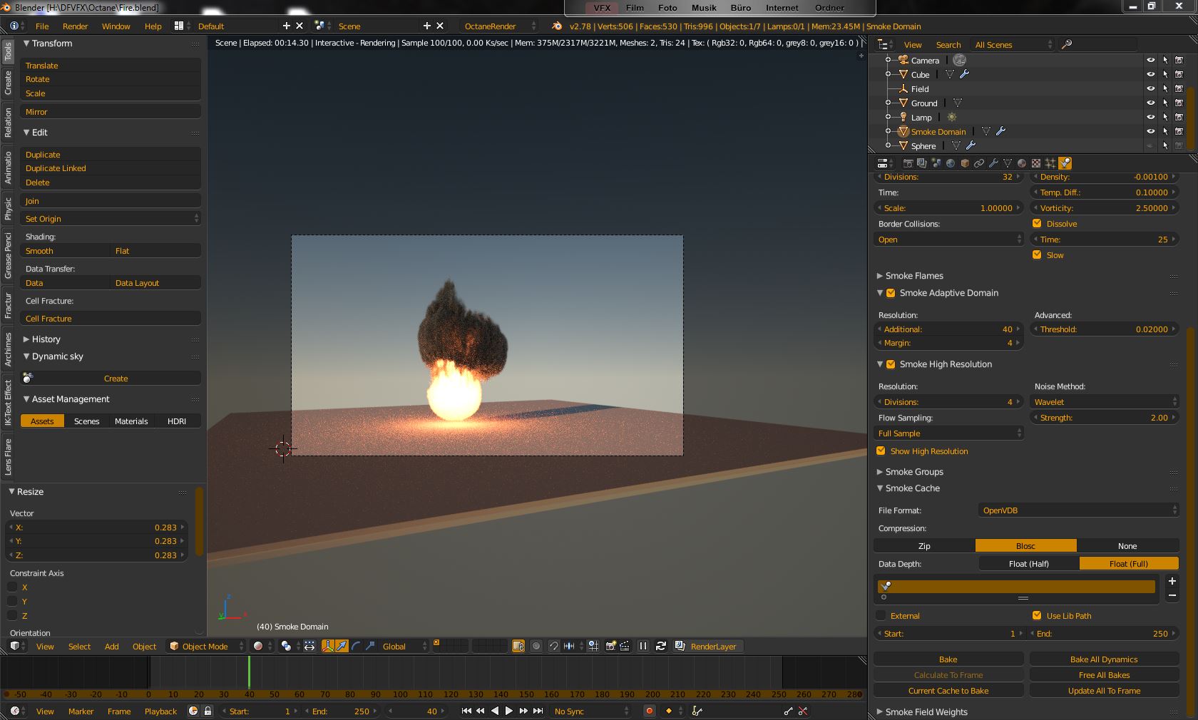

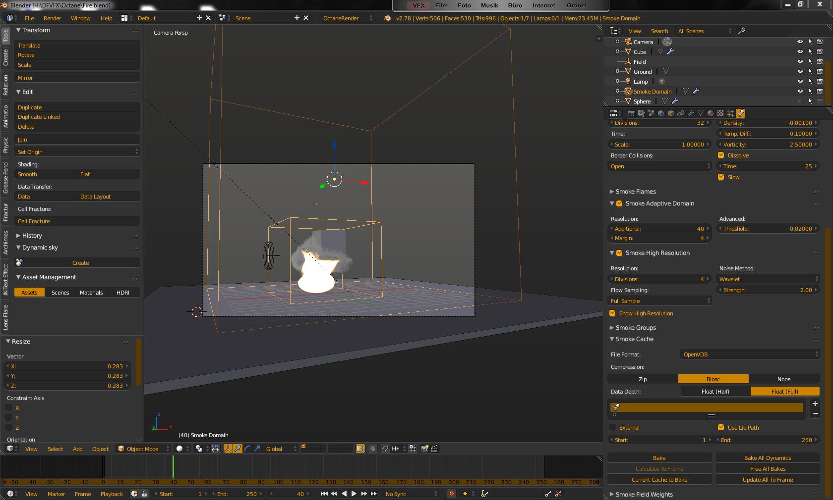

Im sorry, i made a mistake.
It happens when using an "additional-factor" for the adaptive domain.
In unrendered viewport it looks okay, but in rendered preview or final rendering it is wrong scaled.
1- Enable adaptive domain
2- Set the additional resolution to 40 (domain gets bigger)
3- Scale the domain back to touch the ground (gives more finer details)
4- Play the animation till frame 40 in example and then stop it
5- Compare the viewport with live preview or final rendering
Greets,
Dennis
