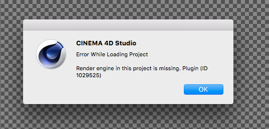

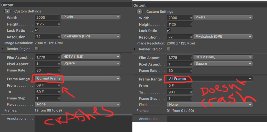

Has anyone else experienced this:
When network rendering, if i try to render a single frame i get an error. but when i do an animation it works fine. From Mac to a Pc both running:
C4d R18.028
Octane 3.03.3

aoktar wrote:Do you have octane plugin on other machine?
Yea both machines are running the exact versions of cinema and octane.
When i try to render a single frame the error pops up but when i add more than 1 it works.

What's crash? Error message in your first post?
Francisco
Posts: 18
Joined: Tue Dec 08, 2015 6:39 pm
Yea, the error is from my first post.
It doesn't crash just doesn't render.
The workaround is just render 2 frames instead of just one.
